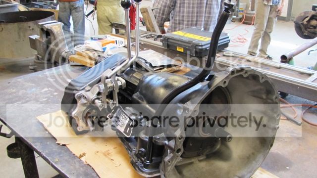

In addition to the Propowder Coating Help, we also received our twin stick set up which was generously donated by Jon at JBfabrications. He was excellent to work with and we will be installing the twin stick set up next week. Pics to come...

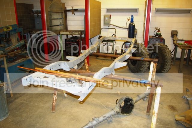

I am slowly getting a few side projects here and there from our work already. The last teacher managed to mess things up pretty bad and loose all community support. A few people have seen our work and are giving us small side jobs. Really we went from a shop with one incomplete set of Harbor Freight tools to a shop with 2 set of hand tools all craftsman(Less cost than snap on and they gave me a hell of a deal (over 30% marked prices on $2000+ worth of tools). We also got a parts washer, impact gun a couple dewalt drills etc... To bad we have such a small shop. When we win KOH in 8 years we wll get our 6 bay shop with paint room... LOL!!! My students all think we should build a KOH buggy... I told em when finished I will let the Senoirs drive the buggy with thier parents for a day on the local trail...

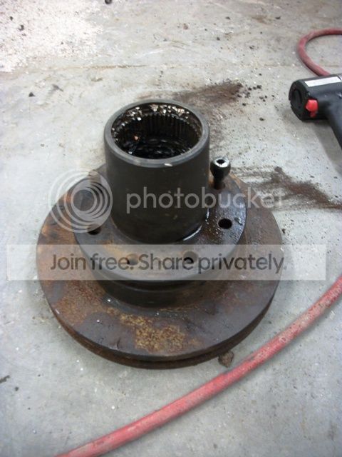

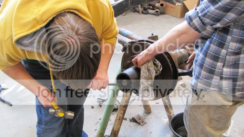

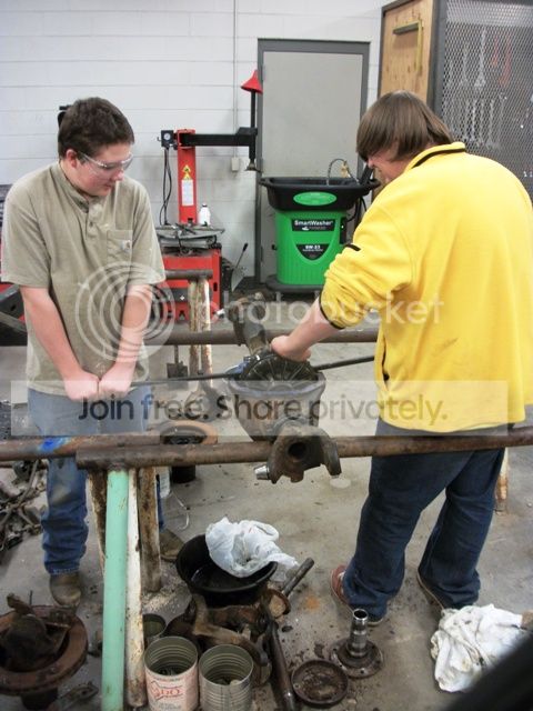

So things are picking up a little. 3 hours a week is not enough, lol. Things have went well. We have started taking down the dana 60. So far both hubs pulled off. Bearings races look good and well maintained, but the rotors and calipers were shot, part from weather, but also one rotor was dished in about 1/4 inch from wear. We will be getting new calipers and rotors each side.

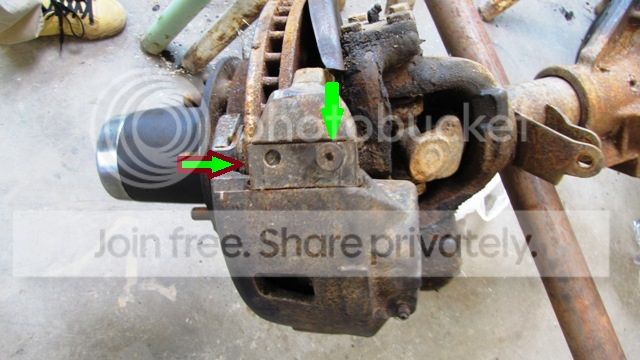

Incase anyone is wondering or ever needs it, dana 60 calipers are not held in by 2 bolts from the back. Instead it is a single allen head bolt and a wedge. You remove the bolt then tap the plate in to the middle. It will all come out then come off like other calipers.
We also finished up all work on the 300 and the tranny. We opened up each enough to look for any major issues. There were none. We also got them back together, and the students were given the twin stick set up to install. the set up came from JB fab and is very nice, complete and easy to install. A student will be doing a full write up on the installation. Thanks again JB fab

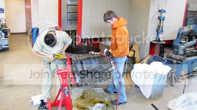

We also continued to work on the motor block. We have oil pan, valve covers and pulleys at the powdercoaters. In once the block is all cleaned next class we will paint it gloss black. The parts getting powder coated are going to be plum crazy purple. We also have a brand new edlebrock intake, and a new gasket set, we recieved a new cross member from Genright. I am ordering parts from MORE today as well. Here are few more pics...
Cleaning the motor...

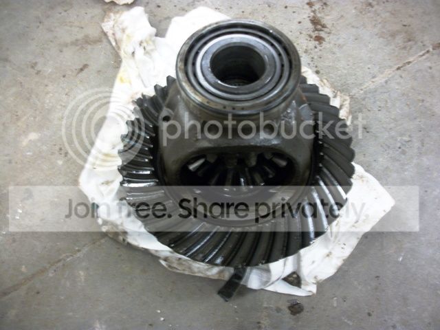

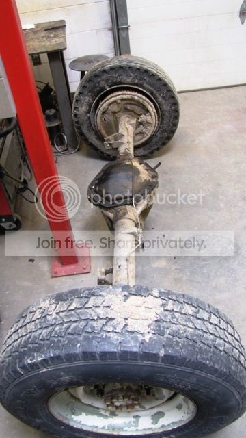

The 14 bolt we took out of a van last Friday.
And our rear cross member:
Hopefully I can figure out how to make things go faster... We have already done a bunch of cleaning and organizing. It has helped a ton just getting things set up.

Glad to see your students wearing safety glasses, a friend of mine has spent the past year struggling to keep vision in his left eye after getting debris in it causing an infection. 4 eye surgeries and a cornea transplant, that his body keeps trying to reject, and he's still not out of the woods. After seeing him suffer I religiously wear safety glasses now, it's a great habit to get into that I used to not do, and have taken for granted many times...
I don't think anyone asked yet, but what's your timeline for completion? I wish we could have done a project like this back when I was in school.
Just looked at the pictures again. Poor kid in the yellow is getting a bald spot that is how mine started. But smier makes a good point on the eye protection I know I am guilty of that too but try to always wear them a good point to stress to them.
I actually chewed thier butts today after looking at pics. I found a couple where they weren't wearing em. I get on them all the time. They are actually really good about it, I usually only catch one to two kids a day. After I say something they get them back on.

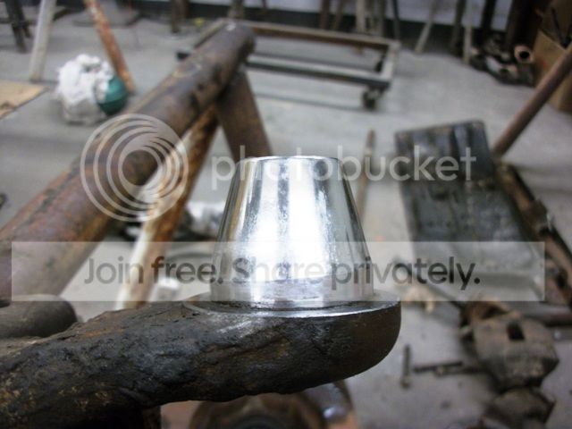

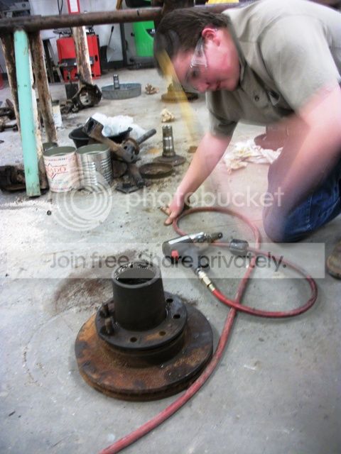

So today was a pretty good day for progress. We managed to get the dana 60 completely taken down. King Pins look good, sleves look wore so I will need a king ping over hauls. Lower bearing looked really good. We pulled the carrier, ring, pinon, inner axle seals, etc... The housing will be sent to sand blaster along with the the other rusted parts. We also pounded out the wheel studs the good old fashion way, lol... The rotors need replaced and the calipers also. So far all bearings look really good so just seals. Need to order the gears and instal kit.

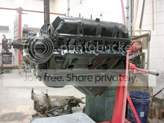

In addition to the dana 60 taken down, we also finally got the motor cleaned all the way down with wire wheels, and de-greaser... A couple layers of paint and it looks good. Just need parts back from the powder coater to finish it up.

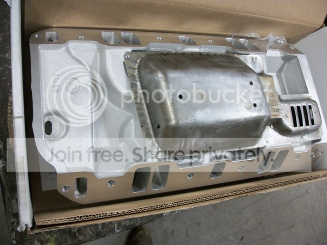

We also got our intake in and cleaned the factory heat shield up and attached it...

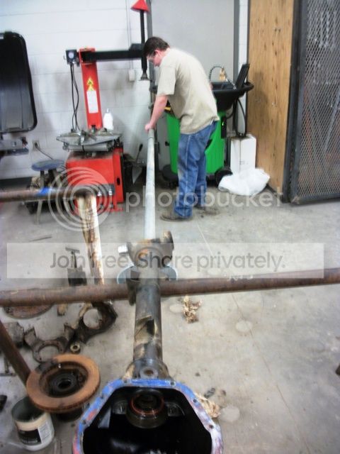

So we had only 1 big pipe to get out the axle seals... It worked, but next time I will remember my set up from the garage...
Engine looking good and new:
Our King pin...
Removing the studs...

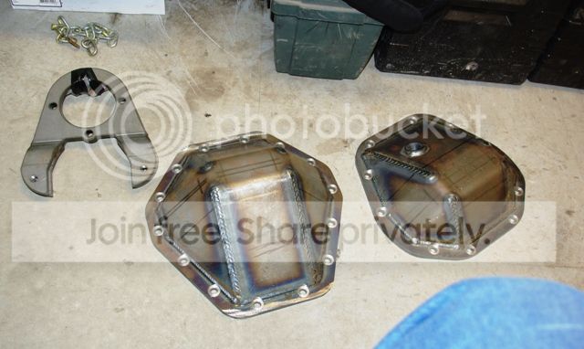

Our next big thanks goes out to Ruff Stuff. They generously donated 2 heavy duty diff dovers (14 bolt and 60) as well as disc brake brackets for the 14 bolt. The stuff is amazingly heavy duty and of great quality.

Also to refresh we also had a twin stick set up donated from JB Fabrication for our dana 300.

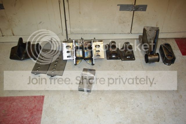

And Crab Tree Tool donated some heavy duty front and rear hangers and shackles.

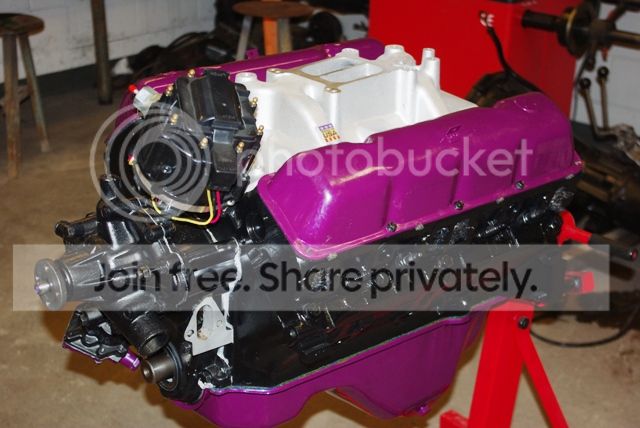

So here are our projects. We have begun installing the final items on the 360. This month we finished the paint job on the block. Got our powder coated parts back from Propowder Coating. We clearanced and rebuilt the oil pump assembly and also clearance the water pump. We got the Oil pan installed, water pump/timming chain, and oil pump installed. We also installed the intake, valve covers and got a new HEI distributor. The finish is nice and glossy, we just had some greasy finger from installing cork gasket.
Here is our engine as of now. Gloss Black and Plum Crazy Purple... I like the look. We also have the pulleys in Plum Crazy and the motor mounts will be plum Crazy as well...

From M.O.R.E: We have a set of Bomb Proof Motor Mount, A steering Box Brace, and the front end full width kit. It is a great kit and very heavy duty.
We also have the Ruff Stuff Diff Covers and 14 bolt disc brackets:

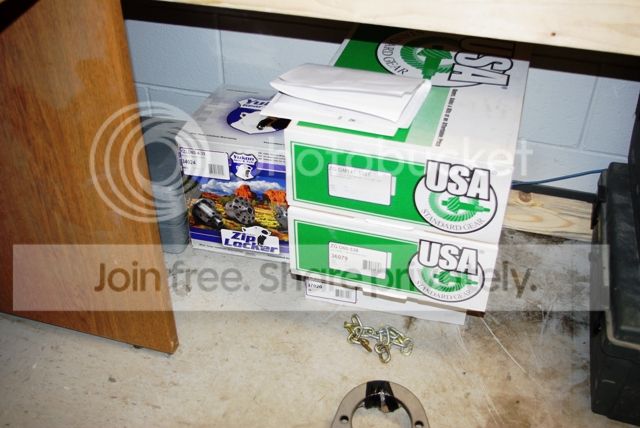

We have the gears/locker and install kit here:
