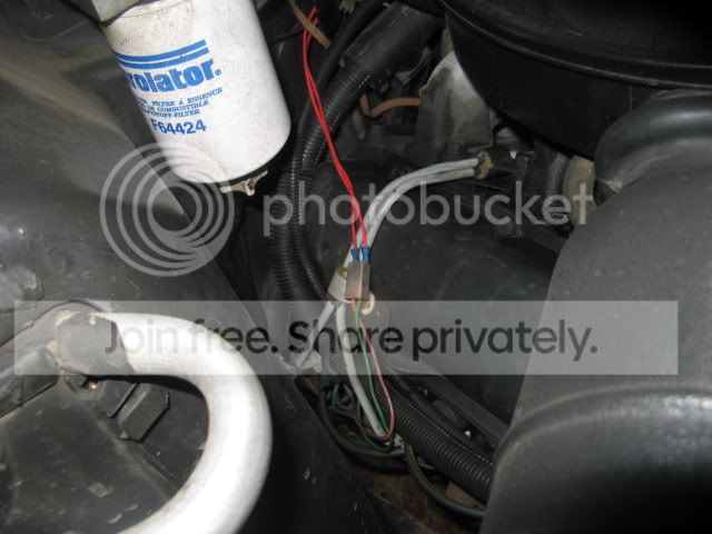

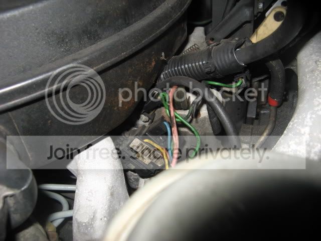

Here are a couple of pic's to illustrate what I did to have my HPCA work off a toggle switch.
First pic shows the green wires at the IP, these need 12 volts to energize the HPCA.
You don't need to do anything at this end of things, you need to look farther back in the wiring harness on the passenger side near the rear of the engine. You should find a grey two pole plug with one green wire, and one pinkish/red wire.
Use a test light and confirm when the key is on you have 12 volts at the pinkish wire. As you can see I ran two wires from this plug to under my dash and into a two pole toggle switch. You can also see how temporary my set-up is/was. For whatever reason there is no temp switch on this 6.2, yet the plug and wiring are present. I have a temp switch in my other 6.2 that I need to swap over...then I can get rid of the stupid switch.
Generally I'd flip the switch when the motor was cold, blip the gas pedal about a 1/4 throttle to allow it to set high idle etc with the HPCA energized and fire it up when the glow light went out. I'd leave the HPCA on for the first minute or two, then turn it off and it worked great that way.
Rene
