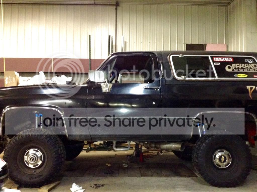

The 2.5s i have on top, the new shocks on the bottom. It would apear the piggyback is still about a 2.5, but the shock body is 3.0. Not much info yet.

I already have a full shock mount kit to mount them in the front of these rigs with clearing the steering shaft (cant do the ford towers because the shocks are way to bit to fit between frame and shaft).
But im all about these things. I just finished my mounting of my rear ones. I bought 4 rear raptor shocks for a total of $700 2 years ago.
This is basically the exact same shock for about $1300 a pair new.

I was told on the front ORD springs that they are good for about 11-12" of travel before you start to deform them. I have my bumps setup to use just about every bit of these shocks up front.
In the rear my shocks are angled a bit so im betting ill be able to play with my shock mount hole locations and squeeze 14" of travel out of ORD 52s. (gonna run the stockers for this summer with air bumps spaced down from the cans to see what I can get out of a stock set of 52s, but with everything welded in to work for the ORD springs).
Chris at ORD told me my springs would use "all of a 14" shock". I redid my mounts for 14's up front. In the rear I have 11's now, but they are bottoming out too soon. I'll probably go to 12's and live with it.
Have you checked to see what happens when the axle goes free up front? I assume the shocks are the limiter unless the driveshaft hits something first. I'm still figuring it all out, but pretty sure I'll need straps if I don't want to damage my shocks over time.
