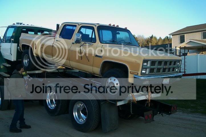

Get one of these
Put in a cummins, NV4500 tranny, and a toolbox in the back. :thumb:

Get one of these
Put in a 6.2 Diesel, SM465 tranny, and a toolbox in the back. :thumb:
If I didn't know any better I would think you are trying to sell him this truck:whistle:
No, my buddy just bought it and im gonna steal it from him cuz im in love with it :D (ok i prolly wont steal it.... But i want it soo bad)
