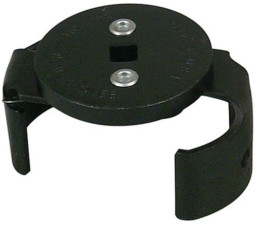

I've been fighting with these dumb "oversized socket" style ones and they never seem to fit properly. I'm guessing there is no real standard on the size of the end of a filter? Sometimes they won't get on (especially the "grip" filters) and today I had one that would not catch for anything. Anyway, I'm considering this one:
http://www.amazon.com/Lisle-63250-Range-Filter-Wrench/dp/B0002SR4PY
Opinions?
