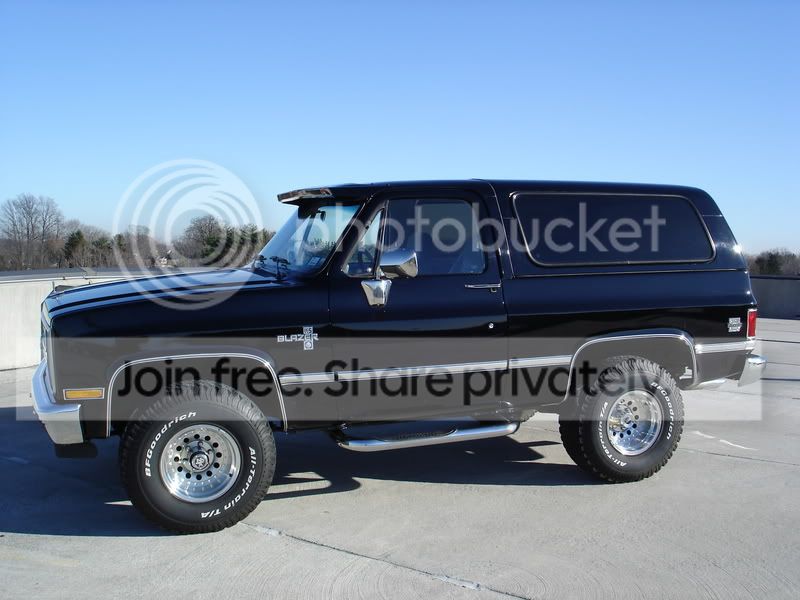

Oh and here is a picture of my truck...

BTW; what size tire you running. Nice looking K5. Is it black or dark navy blue? How does the inside look? I almost went with a single dark blue instead of keeping the two tone. Mine has the light blue interior so I didn't have any choice but to keep it blue on the outside.

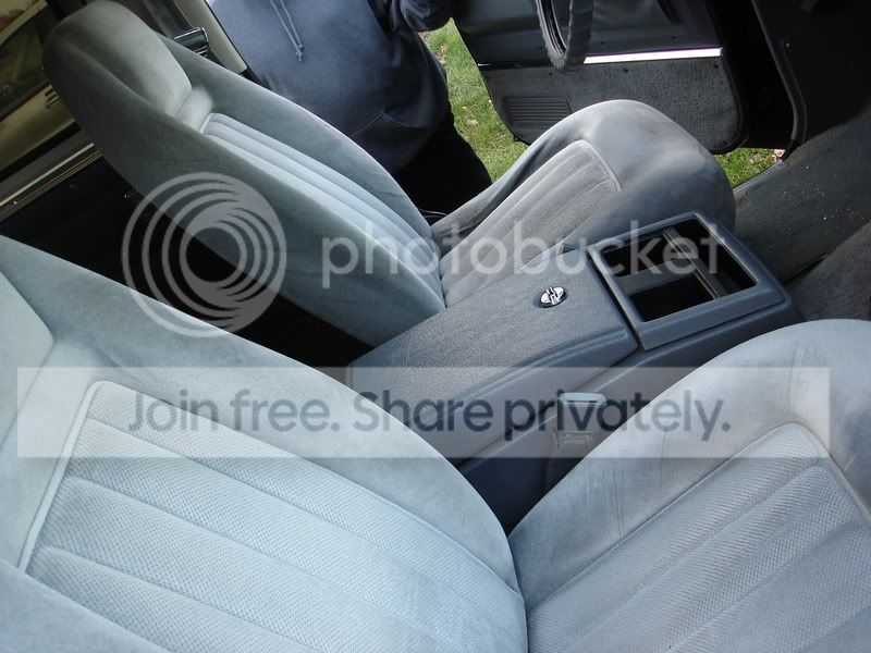

The truck is Black with a gray colored interior. The tires a re 33 x 12.50 R15 LT BF Goodrich Here is a pic of the interior...

Wow!!! That's a sweet ride, brother!!!! :bow: :bow:
