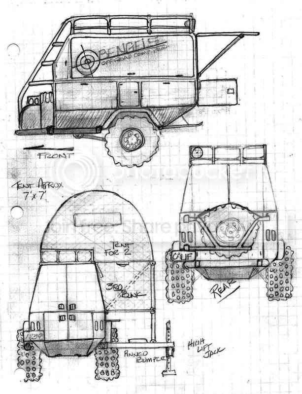

Sorry just riffled through your post and missed the specifics. Just thought it was worth a thought. Im going to be building an off road expo trailer also. Mine will be a bit different in that I want it big enough to haul 2 dual Sport KTM's. This is my doodle...
Cool drawings....I like the doors from the outside for access too.
Nice setup.
