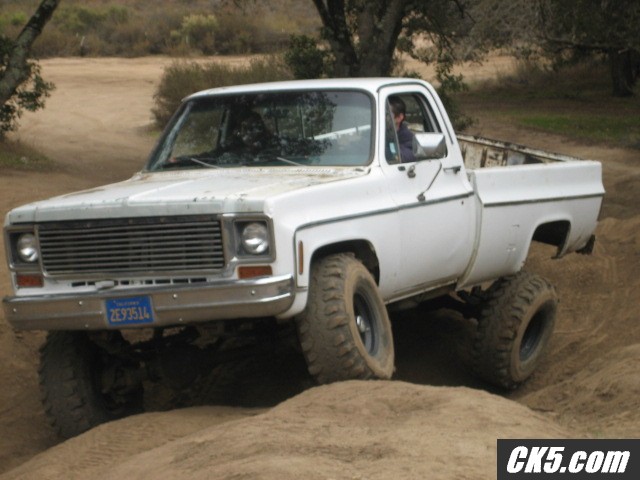

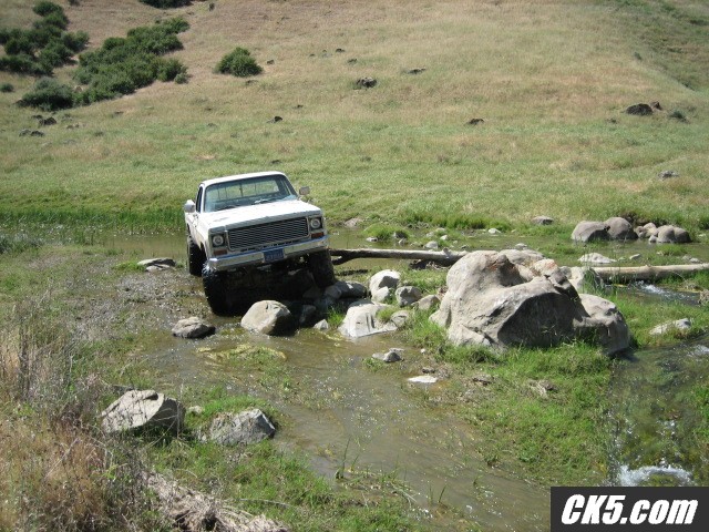

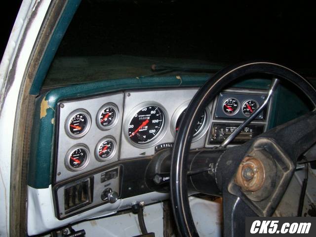

The white truck started to get built, it had a 74 350, th400 trans, and np203 transfer case. 14 bolt rear with 3.73s and a 60 front with 4.10s lifted on a 6" skyjacker lift. Here are some pics...built the dash, painless harness, crossover, etc. I also scored a rear 14 bolt with detroit from craigslist, so i swapped that in.
At this time I had a set of 36inch tsl's, open front, detroit rear, 4.10s, and a th400/203. I purchased an ORD doubler and I got a 1984 700r4 from craigslist and gave my buddy the trans to rebuild (gm transmission tech). I put 39.5 TSLs on 15 inch 8 lug rims, grinded the brakes until the rims cleared. Then went to hollister for some wheeling...

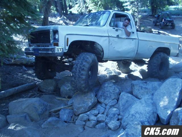

Took it to tahoe as well...
That tahoe trip I had a hard time getting there, the carbed 350 wasnt cutting it, the trans was hot and angry, and max speed was 25mph.. I ended up limping it in to Tahoe, on the way out, I attempted to drive out hwy 50 up echo pass and the rig wouldnt make any power off idle, so we strap towed it on Hwy 50 to the top of the pass and I coasted it down the hill to Fresh pond and had it towed to my grandpas house in georgetown. It sat there for a while as I live 200 miles away...I drove up there several times to get it running, but to no avail, it needed a motor. I had to tow it back to San jose.

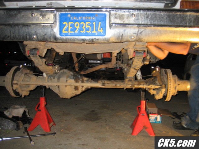

When I first got the Blazer, the valve covers were missing and oil was everywhere thanks to the thieves who joyrided it and jumped it. I swapped my one ton axles and used the existing blazer driveshaft. Gutted the white truck and just gave it to my buddy for scrap for letting me use his yard...Drove the blazer home on that smokey 350.
