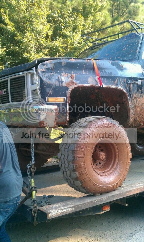

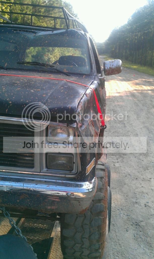

i laid my 86 on its side wheeling. the hood drivers front fender and the door are shot but thats a bolt on fix. my roof rack pushed the roof of the cab in over the drivers head up by the windshield and made it to the windshield frame.. also pushed in at the top of the door about 3/4 of an inch . would i be better off using a junkyard cab or is what i did fixable?
i know the picture of the roof is crappy ill take better pictures tomorrow. and i definantly dont wanna chop the top on this one
From what I see it's fixable. I just went through this. We just used a port a pull and a come a long.

havent taken it to a body shop yet. i guess i should and have have them look at it for me to figure out what to do

Looks like you can get away with just a fender, hood, headlight bezel, and a door. The roof doesnt, from the pic, look like it tore up the window frame to bad. We did something similar to that way back when I was young. We just sat on the seats and kicked the roof back into shape :haha: and just got a new windshield and set it in a thick bead of caulk and tooled it to make it look like a seal. Now I know the wonders of a portapull and come along.

im a mechanic but never learned body work. how would i go about properly using a hydraulic porta pull becasue we actually have one at my best friends house for body work. we just dont exactly know how to use it
Set the base on something solid, like a good area on the floor pan, I always use a plate of steel or a piece of wood to spread the load, and the other end just pushes. Basically like a jack.
hmm what we have is some sort of puller then. it dont push i dont think. how hard is it to get everythign to line back up the way it was before?
To be honest, you will probably never get it "straight" again. Metal likes to shrink and expand when its taken a hit like that. You could work tireless hours on getting it right if thats what you want, or you can just get it to take the window, and seal out the elements and call it gravy.
