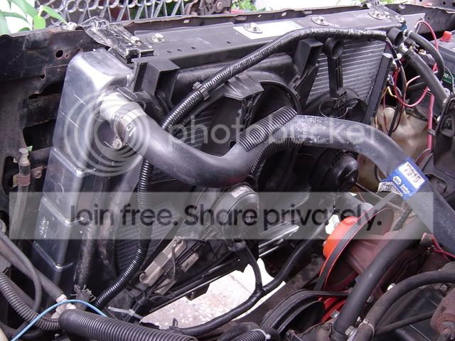

I put a dual 3-speed setup from an early 90's Cadillac into my K5, but I also put an aluminum radiator in at the same time. I have ZERO cooling issues, and I think that if I left the fan off, I'd still cool just fine. I'll probably try it one day......
Anyhow, I had a taurus two speed setup with a less than desireable homemade shroud, and it cooled okay with a standard four core radiator. Once the cooling fins started rotting out in the front of the radiator, my cooling SUCKED! But aluminum radiator+electric fans+happy motor.
http://img.photobucket.com/albums/0903/mofugly13/DSC04674-1.jpg
