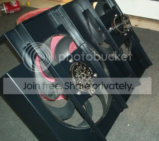

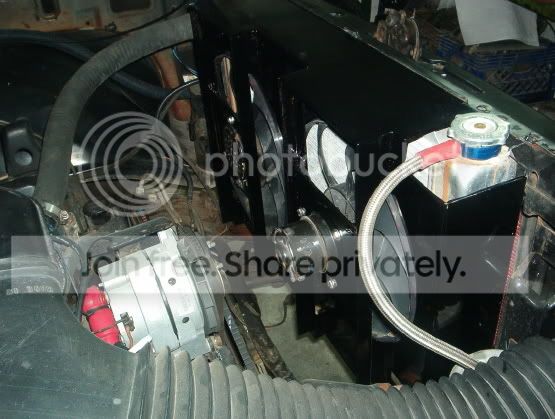

I have the 270-290 and it is FAN-tastic...lol. But seriously I have had no problems with this bad boy. You can feel it suck the air in while standing in front of your truck. I can take a piece of paper and hold it about a foot away and it will be sucked into the grill. Now thats some serious suction. The temp gauge drops very fast when these fans come on plus they come with a temp. control knob for when you want them to come on. Easy to install as-well. Lots of munting hardware was included. They are built into there own i peice shroud. Top quality stuff.

i would think that could handle a stock sb.... especially if its dual.. obviously mounting may be an issue....
hopefully i'm mounting mine this weekend.. just started the harness tonight, so hopefully the mechanical will go bye-bye on sunday... The windstars huff a good amount of air....
