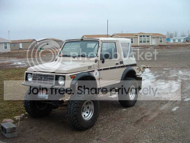

I am thinking about getting one. I would never sell the Burb, But sometimes I get left out, Because I cant fit!!! I like the rig.
By buddy wheels this one, And Its super fun to ride in.

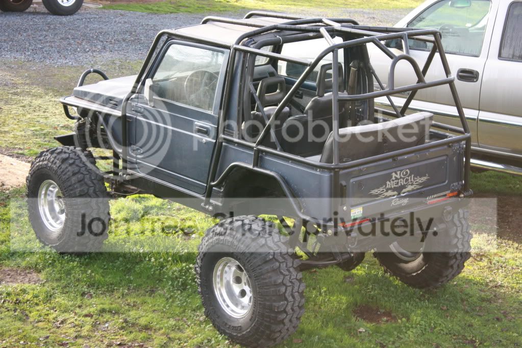

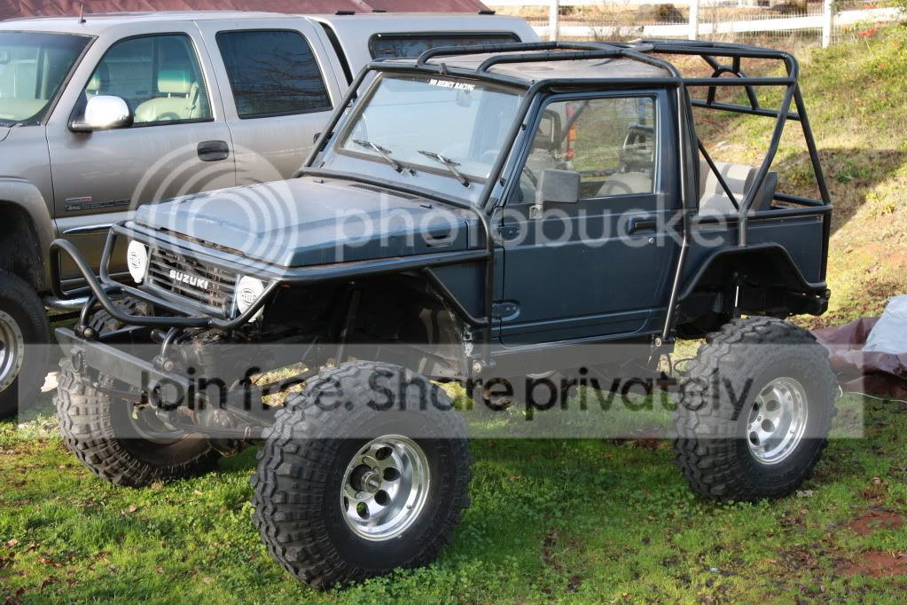

Just for kicks ( pic whoring) here is the last sami I had.
SPOA with rears up front and a SR and CJs out back with a missing link. Custom steering (what would now be called an OTT kit) 4:1 t case 5.38s lockrites both ends, traction bar, 1.3l with a backwards weber sliders 33s etc etc etc etc
It went pretty good. I could put it just about anywhere I wanted to and I knew the limits of the axles so I didn't break that much
Is that on stock axles? I don't know all the zuk lingo like sr's an cj's
Yep stock axles ( well kind of stock) they had birfeild rings on em.
I used CJ-7 rear springs with an extended shackle thingy called a missing link, SR is shackle reversal, OTT is over the top steering.
The motor in it was sweet, samis run a reduction in high range so that coupled with 5.38s in the diff meant running about 5500 rpm at 75 mph and it would do that all day long and get 20 mpg too.
I also had custom shock mounts with 14" travel shocks, it flexed pretty good. I need to scan in some more pics my buddies have found we lost alot of pics in our housefire.
I had also redone the inside of the wheelwells and moved my flares up a bunch and modfied the firewall to fit the tires. Those 33" SSRs were the same as a 35" BFG so pretty tall tires. Wish I had a pic of it but I had it on some 35" boggers for a while it looked way cool.
They would really make a good basis for a buggy if you want a fully weatherproofed buggy with a full interior already done. Seating for 4. Even on toy axles it makes em wide enough you aren't going to readily destroy the body. On tons the body is damn near impossible to damage.
I had some good times in that rig, that was back in the day when samis didn't get any respect at all. So it was fun showing up somewhere and everyone going hmmmmm a lifted sami, well we got bigger trucks here so when you roll over or can't make something we can pull you out. Then go and do most obstacles with no problems.
