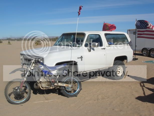

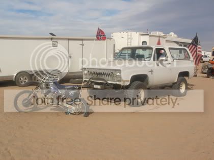

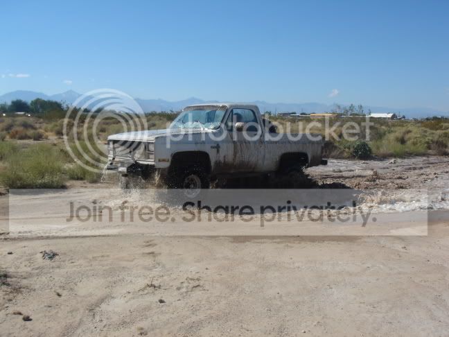

i do want to change gears but i dont know the first thing to even look for to buy 3/4 ton gears. My truck is a 83 k5 blazer with the 6.2 diesel under the hood. as it sits now i have 2 inch adaleafs and two inch body lift. siting on wagonweel rims with 33s. i want to build a good all around truck. i do a lot of rock crawling and desert ridding. being in socal there is not much mud. i want to build an all around truck that will be ok with what ever i throw at it.. so here is my plan so far.. i either want to regear the axels i have or just get some bigger ones. i want to run a 35 inch tire at least! I dont care too much about street quality, or gas milage i have other vehicles for that. I dot want as much suspension travel as i can get. i drive the hell out of this thing when i take it out. i have already had to weld a shock mount back into place from the blazer trying to pull a dukes of hazard stunt at glamis... haha.. anyway all your imput is really helping me along. i have been on the phone with a couple suspension companies. and i am starting to get a feel for what i want.
I went out to death valley last weekend and realized i need to figure out this axle thing. i either need new ones or i am going to get lockers for the ones i have.. i got over every pass i needed but it could have been a lot easier if i didnt keep losing traction.....

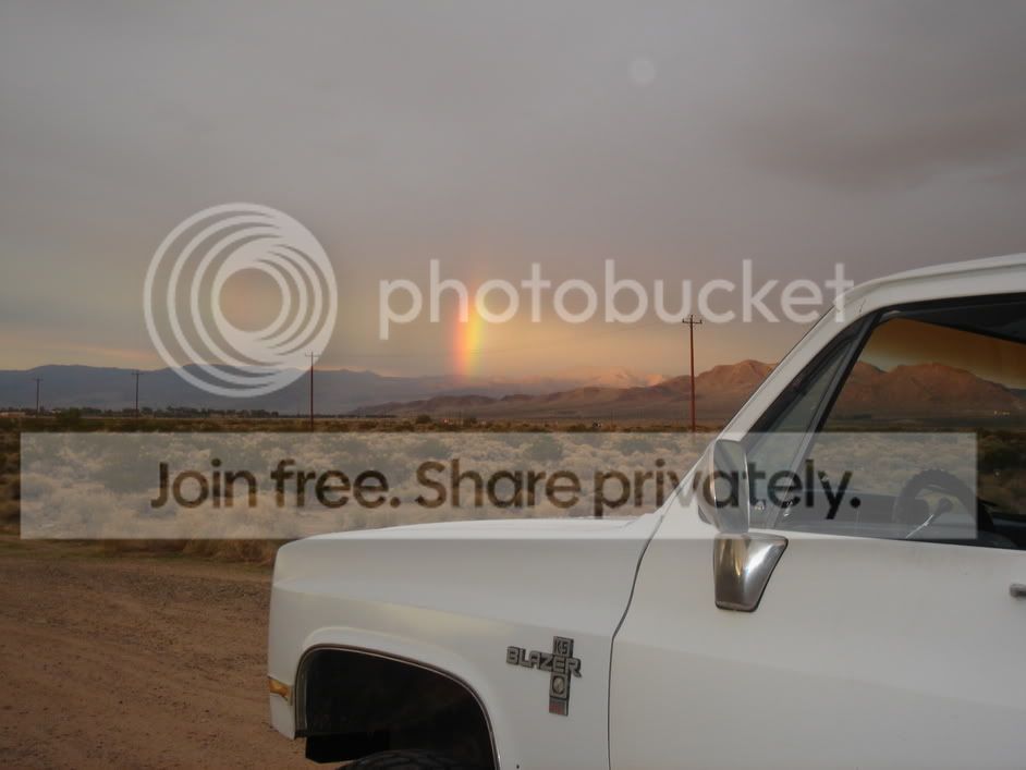

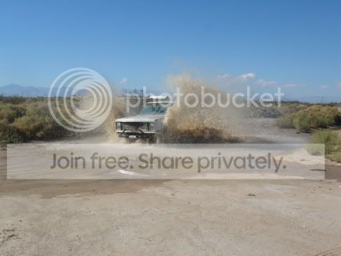

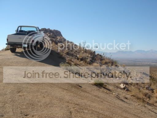

thanks a lot guys. oh and here are some pics of my truck so you get an idea of what i am up to.
hope you guys like my custom grill.. hahah i made that a little while ago after i destroyed the original running into some desert shrubbery... I wish there were just some steps i could follow to build one tough truck.. sorry about all the questions but i am new to building an all around beast of a truck. i know nothing about off road suspensions and axels and gears.. also i want shock hoops i love the look is this a good idea or bad one??
