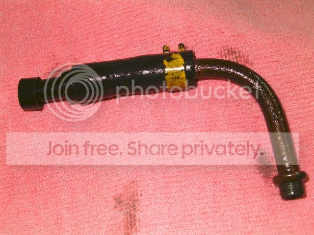

just for reference, this is the vent line from my ~85 model 205. It is a threaded pipe.....
Scott, do you know what size the hole the vent happens to be?
I'm wondering if I need to drill it out before tapping it.

If you SLOOOOW down and read my post i said /\ "tap it for 1/8" NPT". :D
mine was a tapped hole already, but its a round pattern also.
