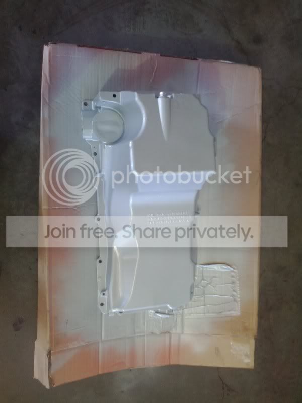

This is the oil pan I will be trying to clear.
I could buy a oil pan, but I already have the truck one and smoothed it out and painted it. :doah:

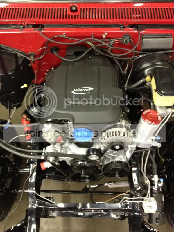

Here is a picture of Tecks truck, you can kind of see where it would sit.

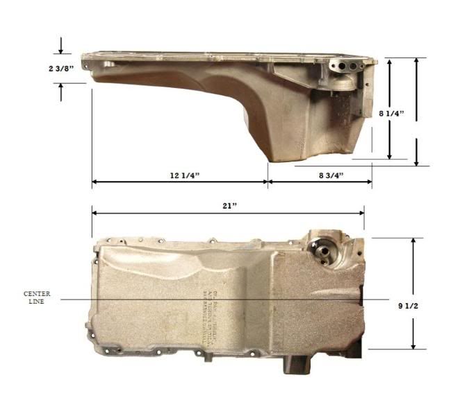

Here is the oil pan he is using.
http://www.jegs.com/i/GM+Performance/809/19212593/10002/-1
