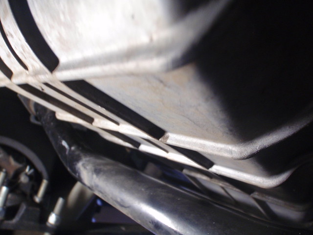

With the DD mounts I was able to slide the motor back a few inches which gave me barely 1/4 on an inch between the pan and the crossmember. If the motor was was in the stock location, it would have hit.
Look in the last half of my LS build and you'll see a pic of the clearance I have.
http://coloradok5.com/forums/showthread.php?t=280586
Here is the measurements
And your clearance picture.
http://coloradok5.com/forums/showpost.php?p=3043163&postcount=65

Late to the party with this but I can confirm the ORD HD member provides a plenty of safe clearance for the larger cast aluminum 8.1L oil pan where there was no way it would clear the original xmember. If the ORD xmember clears an 8.1L there should be no problem clearing the smaller Gen III oil pan :dunno:
