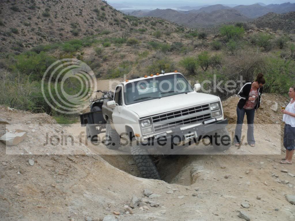

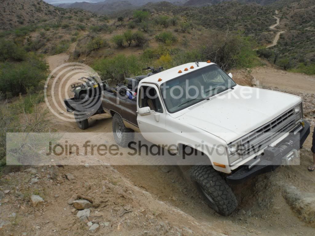

This was a few weeks ago, ord springs up front, tire was firmly planted in the dirt. I'm sure there's some guys with flexier pics around here
^^Does it ride better on just the trail (like behind your trailer in this picture)?

Trail and road, honestly I'd just plan on doing this for every build, unless of course I was going links. I left the stock 1 ton springs in the back and it still rides better than my blazer.
