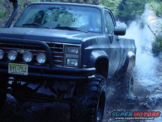

also NJ has 2 stickers too.... for high rise.. that is how our cops know to pull you over.... then you need your paperwork.... has tire size, lift size, bumper heights......
you can see both stickers here...
and for those that have good eye site...
