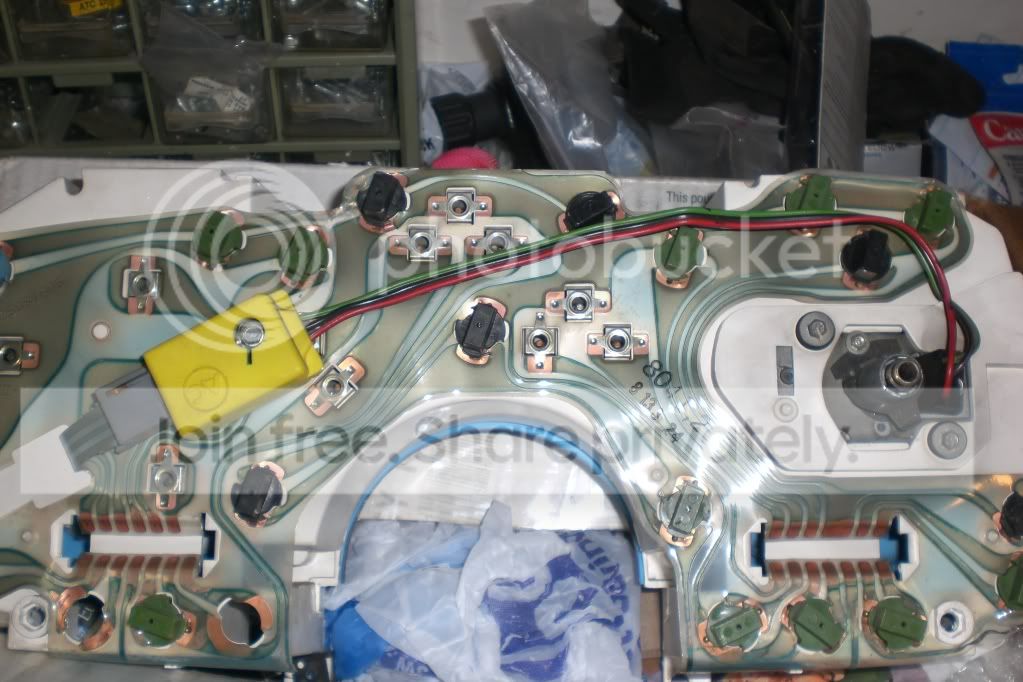

Not identical to trucks, but close enough:
Bolts up in same location, same color wires, buffer box may be the same color, etc.
Plenty of TBI folks say it runs fine without it, however the main issue seems to be fueling with no throttle, ie letting off the throttle while the vehicle is moving. It MAY affect idle, however idle on TBI seems to be much less tied into VSS than other GM injection setups.
Edit: here is our vintage truck cluster mounted VSS http://67-72chevytrucks.com/vboard/attachment.php?attachmentid=759110&stc=1&d=1307730696
good info:waytogo: didn't know that. I haven't had this cluster out before. only the one in my 83. Can that go bad too lol... the current dieing issue has MOSTLY happened when letting off the throttle. Cruising to a stop. letting off after getting up to speed and coating for a second, etc. get a quick flash of the engine light and if I gas it quick sometimes I can catch it. if not it dies, throw it in neutral, start it up, back in drive and keep going...:dunno: Didn't know that sensor was there or that it could affect the engine if it was...

You don't hear of them going bad, but I'm sure they can fail, and so can the speedometer. There is a piece inside the speedometer that the VSS "reads" as it spins, so I assume like everything, that component could fail, but it's pretty solid.
If your cruise control works, probably not a VSS issue. My preferred method of testing VSS operation lol. But you can also hook a scanner up to it, if the scanner shows correct vehicle speed while you are moving, the VSS works.
Even the pre-TBI cruise control equipped trucks got VSS, not sure what year it started (maybe '82 or 83), but when they figured out VSS, they got rid of the fender mounted cruise transducer.
The 90-91 clusters/wiring are still pretty easy to find, but won't be much longer before those are hard to find too. I snapped up a few VSS 241C's and clusters because the price was right.
