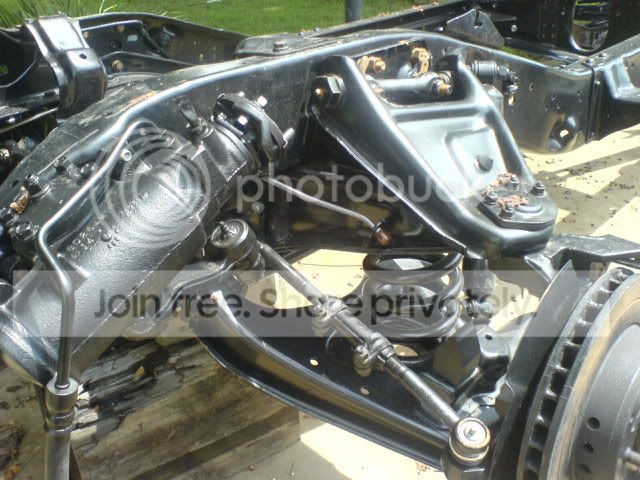

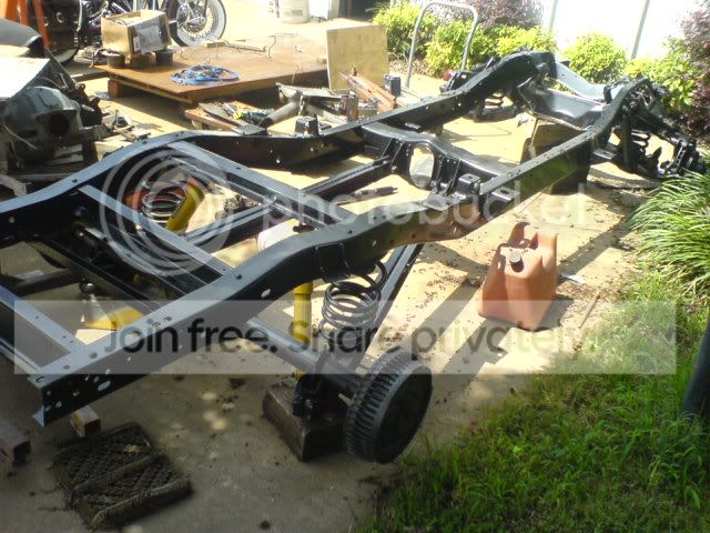

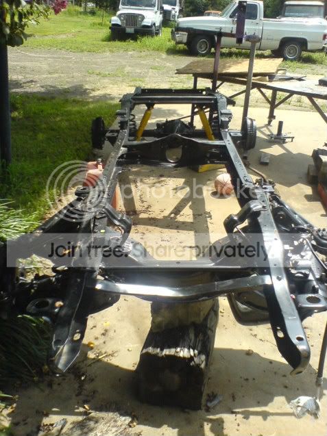

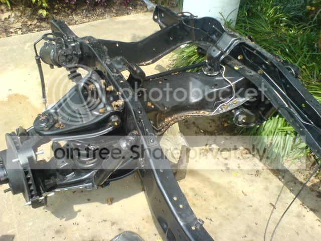

heres a frame i just had powder coated...
thats the 72 frame, about to take the 64 frame in, i have 3 truck builds going at once...a 47, a 64, & a 72, their not mine, I'm building them for other people.
i have the 72 frame ready for the body, but I'm having to put a new floor in it, i had ordered all the patch panel parts i needed then in my last LMC catalog they had a complete assembled floor for the 67-72 model trucks so i ordered it and have it almost completed and ready for the frame. i'm building it for a local doctor and he is in no hurry, he wants me to do $1500 worth of work per month, so for the 1st couple of months there wasn't any real work done, but alot of parts ordered. so..the 64 frame is going to go to powder coat b/c its for an attorney and he isn't worried about the cost to time ratio, so it will get done alot faster, plus the truck didn't have much rust at all, so its been media blasted and the interior has almost been completed and door jambs have been cut in so its time to have the frame done b/c i'm at the point of needing it.
