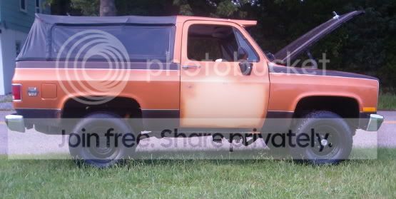

here's my rig back in the day running around with a trimmed out door on it...
