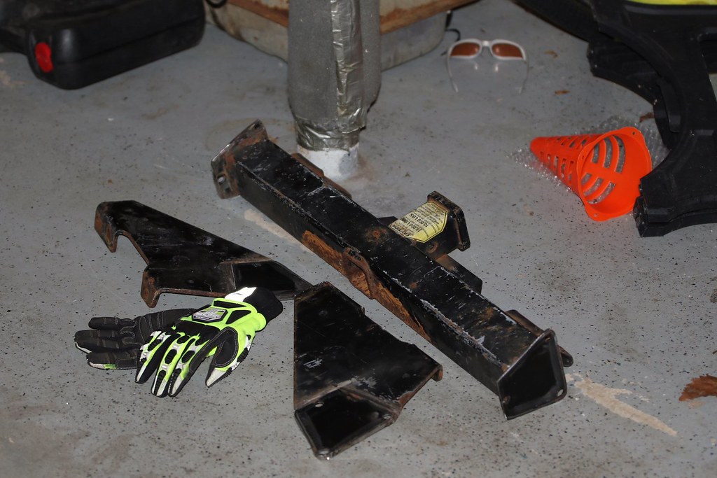

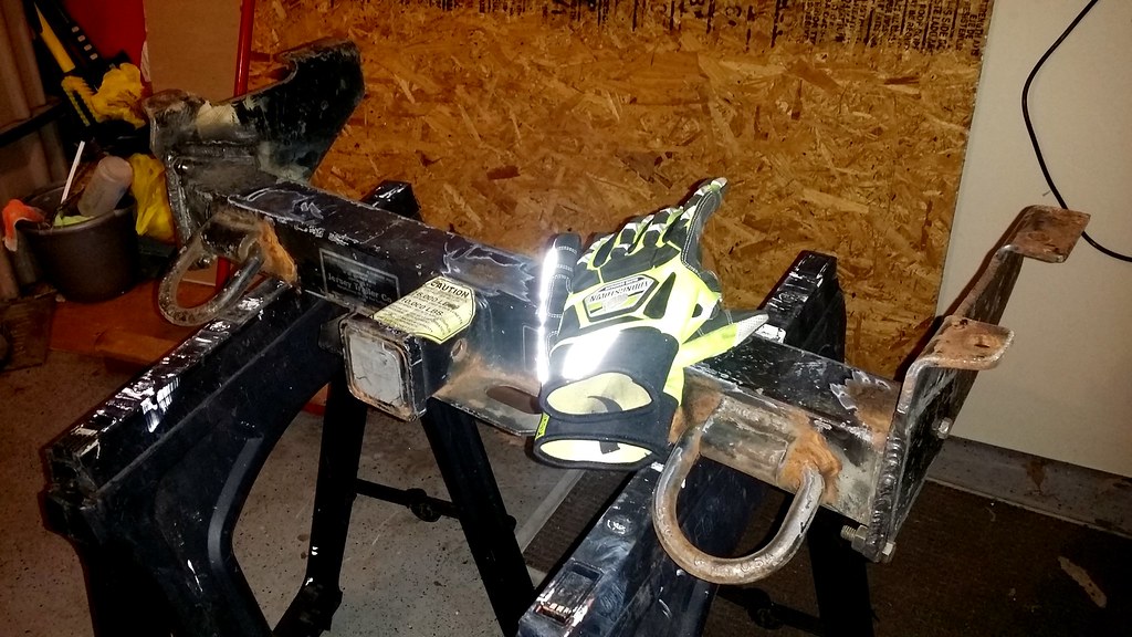

Ok so I bought a hitch 15+ years ago. I knew it came from a chevy but guy didn't know what year. It hung too low on my truck so I just recently got off my lazy ass and ground the welds, removed bolts and took it apart. I then bolted the sides on the truck and moved the center section where I wanted it. Drilled holes, bolted it back together and welded up.
I wire wheeled it and it is ready for primer and paint. Curious what people use. Just plain primer and a mess of coats of black rustoleum???
