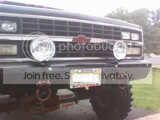

i actually just did my front and rear bumpers. i sanded them down with 60 grit untill the chrome was either gone or wasnt shiny. then i did 2 coats of Rustoleum Rusty Metal Primer. Then 2 Coats of Rustoleum gloss Black. came out awesome. took it wheelin the next weekend and was tappin trees and when i got home not a single chip.

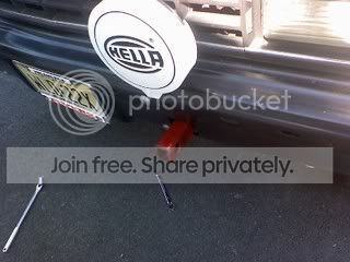

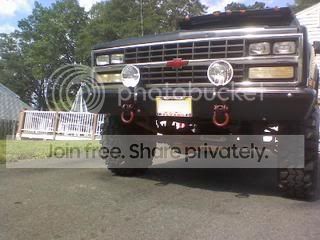

heres mine i did yesterday...i didnt do much sanding seeins how ive got a blazen front bumper comin next week(hopefully) n ill b orderin a rear bumper n about a month...i put bout 3 coats of primer, 2 coats of flat black camo, and the cheapo bedliner spray...works for me...

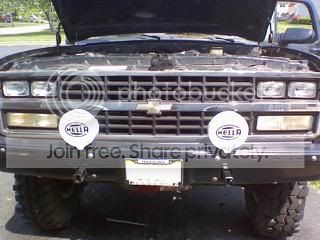

last one is from today after i put my new shocks on. took it wheelin last weekend and bounced off a tree to the left of the passenger side clevis hanger. didnt even chip the paint
the stuff i used was just rustoleum gloss black. all rustoleum rattle cans are anti rust i think and i just used some Ace Hardware Generic spray bomb gray with the same primer i mentioned earlier and it came out fine
