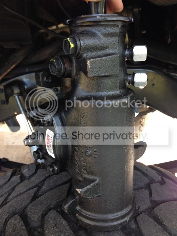

Well... This escalated quickly.
200$ brand new.. Box hadn't even been opened. :D
