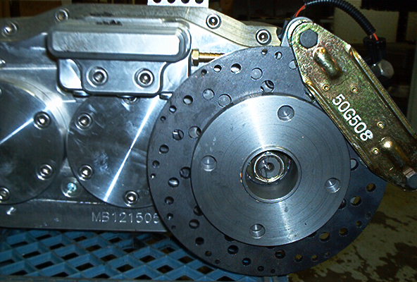

as soon as shane gets em in, ill be running some of his ebrake calipers.
for now im relatively nekkid.

"as soon as shane gets em in, ill be running some of his ebrake calipers" - what are these all about?

I have an electric roll control/line lock that I use for a parking brake. It works just fine and I only use it when I leave my truck for short periods of time on steep inclines. It works just fine and I'm really glad I didn't drop the coin for el dorado calipers because I have been very unimpressed with them from the couple people I know that have them.
