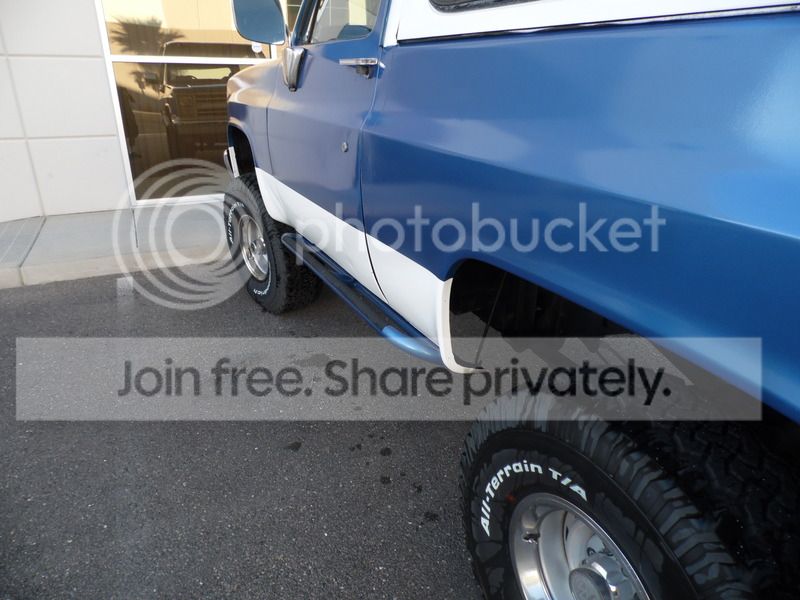

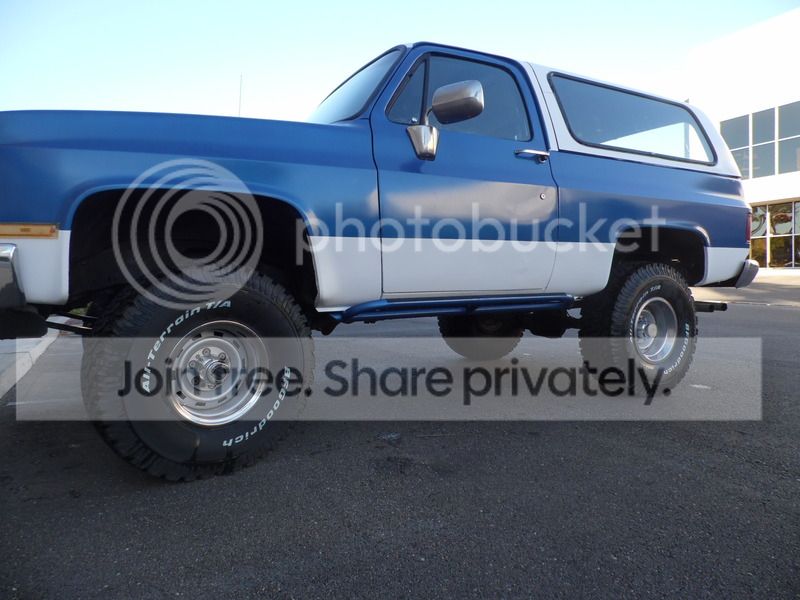

I'm starting to lean towards sticking with 35s. So far I have gotten away without having to trim anything, I'd like to keep it that way.
One of the perks of sticking with 35's is its a little more common size tire to find if you're out on the back roads and you blow a tire in B.F.E. and you need to buy one. I might be wrong but 35's seem to be a "stock it" tire where a 37 would be an "order it" tire.
