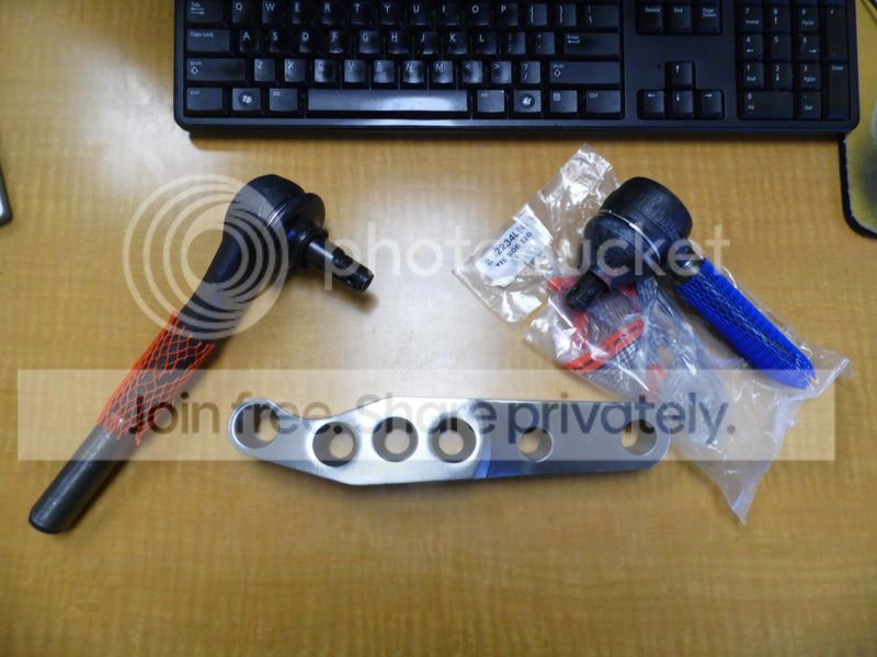

Why does the steering arm have a "standard" and "Large" 1 ton hole?
The tie rod in the picture fits the "standard" hole. I'm guessing that is the passenger side TRE. However, the red one they sent fits the "large" hole. But that would be for the arm on the steering box end.
I think I'll call them and ask them a bunch of dumb questions. lol.
If you have doubts about parts fitting together, call who you ordered from. Went that way on mine, lots of D60 front trucks in our world to share parts with
I called them, it makes more sense now.
They have a 3 1/2" drop pitman arm that is set up for the 1 ton TRE. So I'll order that.
Only thing I need to do now is probably ream the driver's side knuckle for 1 ton and figure out a tie rod with 1 ton ends. I wasn't planning on all this beef, but i guess that's where I'm headed. lol.
