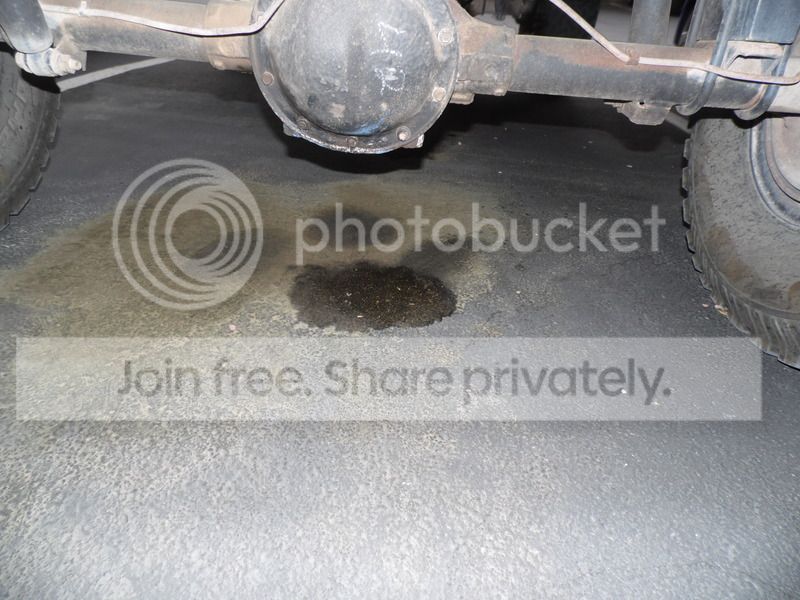

BTW, I beat the lower edge back into shape in the hopes it would save it. It didn't.
I think I saw that happen, even thought to myself that you were gonna need a cover soon. Haha!
You don't want the cover to hang below the diff housing. When you put the new on make sure it doesn't, if it does, grind it down.
Yeah, I was wondering why the factory made a cover than the lip hangs below the housing. There was no way to raise it high enough.
I guess they never really figured we'd be commuting down a pile of boulders.
Yep. When I built my cover (3/8" plate) I Made it protect that lip. It humped a few things, all the oil is still in it.

How much did you cut off the rear plate cover?
I think maybe 1/2" ?? I don't remember now. It still had 14 bolts, can't remember if it still has a header bolt in the bottom, it Allen head.
