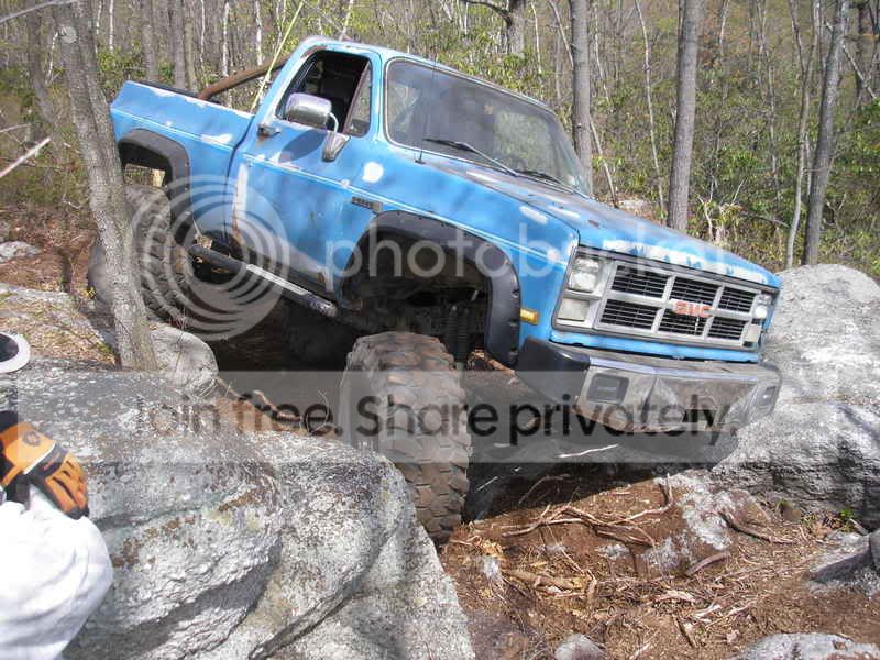

I personally hate mine. But, they came already on the truck, and the PO shredded the fenders, so they won't be coming off.
Here are the same flares.. just bigger tires and crappy paintjob. ;)
i like those! what kind are they? how much more fender clearance can I cut out with them? I'm looking for more tire clearance, but still having a nice finished look.
They are Bushwackers Cut-Outs
they trim like this:
front fender: front ~1-1,5" rear ~2"
rear fender: ~2" both sides.
I have ~7" lift and hade to trim them an additional 1" towards the torpedo wall.

that is what i did however I did 4" on front.....and 0 on back... that way I could recenter my axle without touching the suspension...
