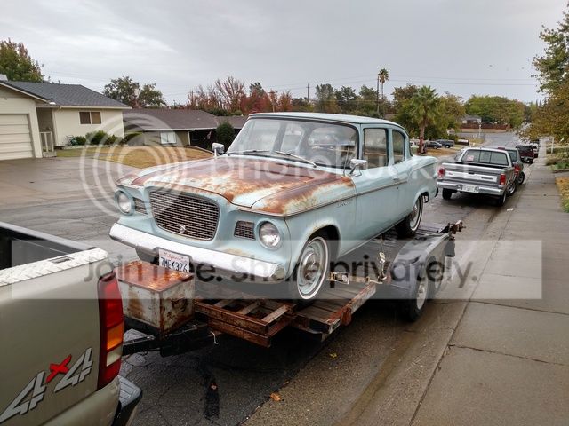

saw it on craigslist in sacramento, ca and thought hey that's kinda neat so I went and picked it up
it's got the champion 6 170ci flathead and 3 on the tree, it runs and drives just needs some carb work for starting but it idles nicely and revs smooth, no smoke and doesn't overheat
all the electrical works and is factory 12v which is nice
needs driver/passenger floor boards and full interior but all the parts are there
plans are airbags, interior, front disc conversion, and maybe liven up the motor a bit with a 2bbl and custom headers and just clean it up and enjoy it

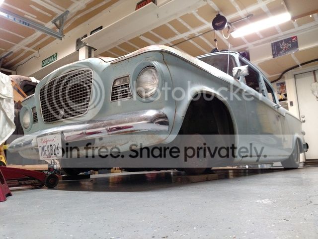

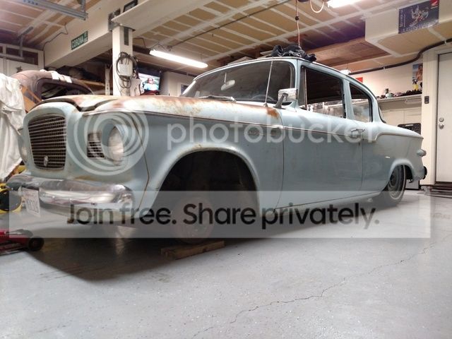

Started some basic mockup tonight I pulled all the leafs from the rear except the main one.
My plan for the rear is to run only the main leaf and a small traction bar to locate the axle and have the bags do the rest of the work.
I would like to see it lay frame so I may go to a lower profile tire rather than do any frame notching just to keep things simple.
