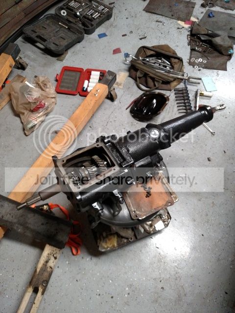

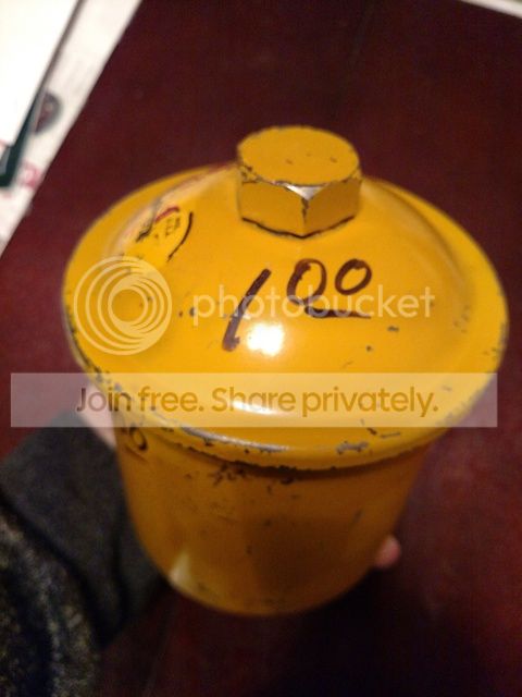

Making progress, picked up a very clean T96 transmission with the R10 overdrive unit, my cartridge style oil filter canister came in, and I put the car up in the air to begin the suspension work.
Might be better to not add an oil filter, and just change the oil more often. A lot of those early engines don't have strong enough oil pumps to deal with pumping through a filter. Adding one can starve the rest of the engine of oil pressure/volume and lead to bearing failure.
From what I've read so far about these older cartridge filters is they're considered partial flow systems and they are supposed to have a flow restrictor on the inlet side for the very reasons you mentioned, basically a metal insert with a smaller diameter hole than the line itself through it.
This keeps pressure in the system and oil saturates the filter element at a fairly slow rate and gravity feeds back down via the oil filler tube on the block.
I'm probably still going to add it on but keep an eye on the oil and pressure until I can verify it's all working properly.
I have seen full flow systems added on as well but requires some machine work on the pump housing.

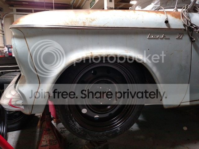

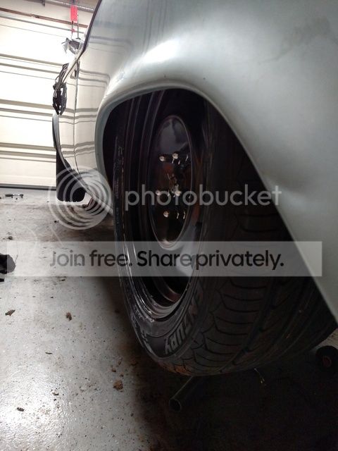

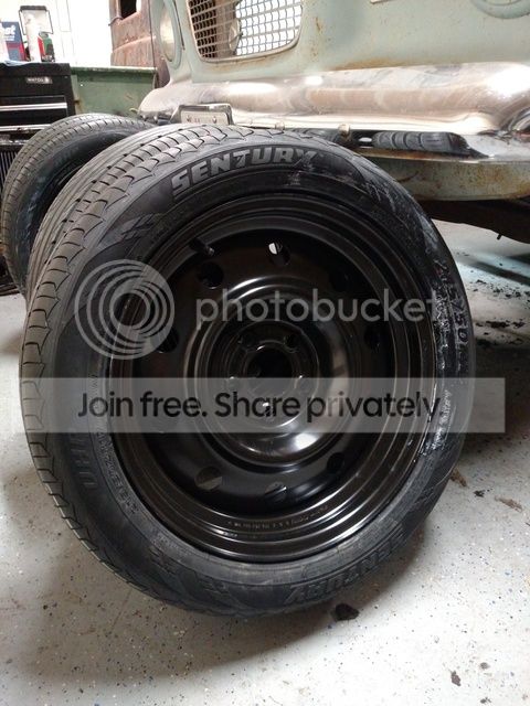

I ordered wheels about a week ago and have been watching the shipping progress like a hawk and today they finally arrived so I went straight to the tire store after work and had them mounted up.
May not be everybody's style but I'm very happy with them and it didn't cost a small fortune either.
17x7 dorman steelies wrapped in 215/50r17 they're about 1.5-2" shorter than the factory size so will drop it a bit but not affect the speedometer greatly.

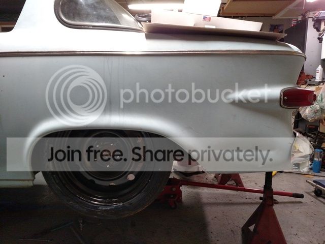

front at full bump

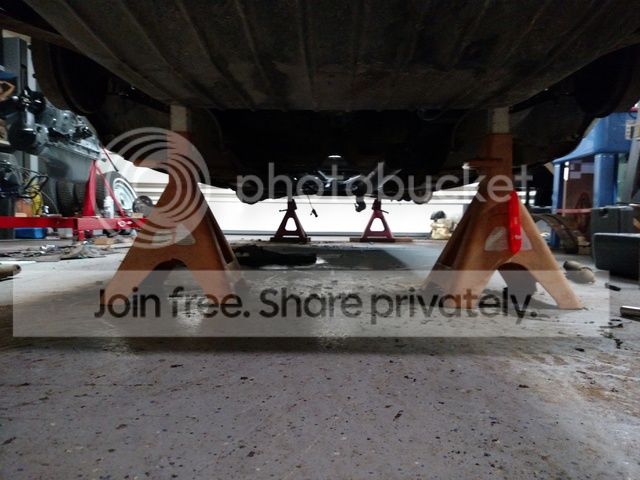

but the rear is where it's at
I'm not saying I think you should, I was just curious your intention. I'd like to see a full profile shot once you get it back on the ground and outside.

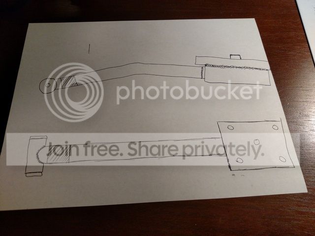

So due to the lack of space to run a typical 4 link setup in the rear and my unwillingness to carve up the Stude, I've been designing a parallel 2 link system with maybe a pan hard bar (if it needs it) that consists of poly bushings at the original front leaf spring mount with a section of tube running to a plate with holes for u bolts welded to a wristed tapered bearing spindle that runs perpendicular to the axle tube.
Wait what the hell am I talking about, it might sound confusing but it's really no different than those pivoting leaf spring mounts used to gain articulation.
This was an early drawing before I realized I wasn't go to need the bend in the tube. I have all the parts ordered so just waiting until they arrive.
The crosshatch area is threads for adjustability. At my projected ride height the links will be nearly parallel to the ground so it should give good road manners.

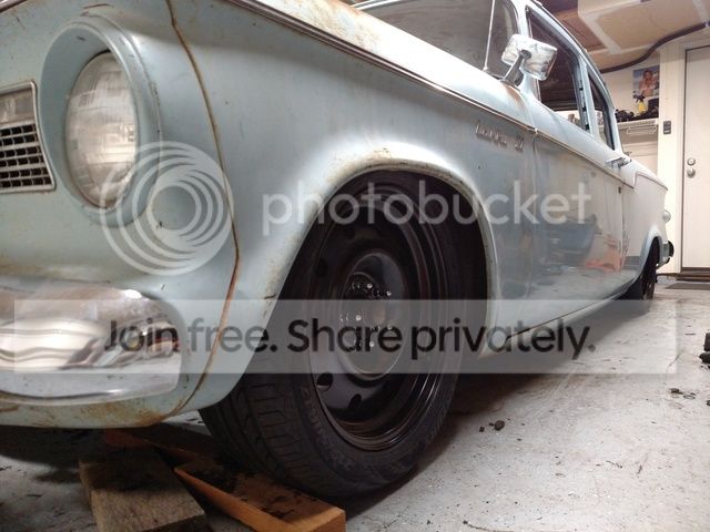

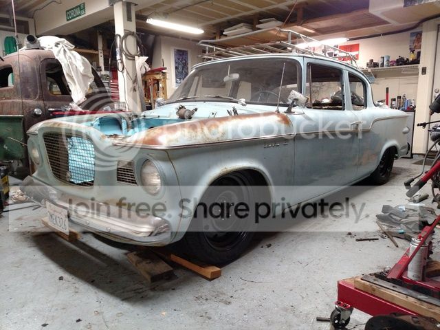

I also put it back on the ground for a couple pictures
