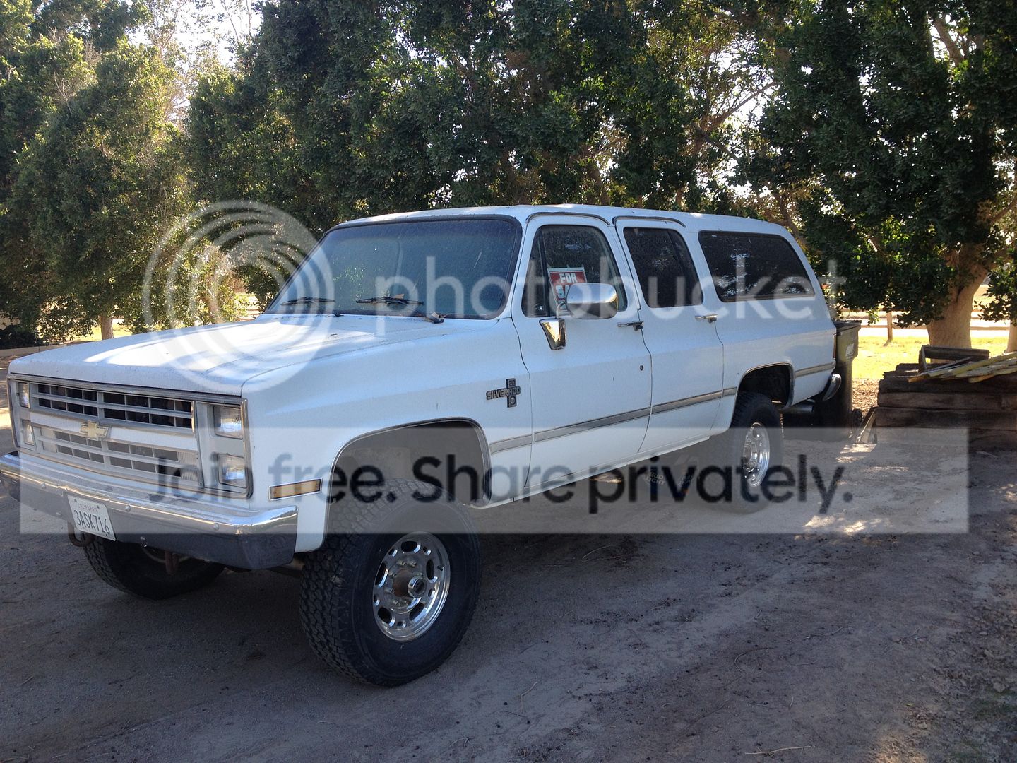

Wife and I have been wanting a burb for camping, a little towing (cheveep if I ever get a round tuit), hauling our kids, youth kids, some DD, trails, desert, etc. Newish burbs are crazy money, can't afford payment plus play money to use it. I stumbled on a nice '87 today, wanted to see what y'all think. It's pretty clean, cruise, AC, PDL, PW, everything works. Lifted 4" I'd guess with some Kevlar tires from 2010, didn't catch the size, 33"ish, prolly 265s or 285s. Think it's 4.10s with a TH400 and a 208, which is about the only weakness I can find, and shouldn't be an issue with my intended use. I went through plenty of 208s back in the day...
Guy is asking $6k for it. 3 Local owners, pretty much garage kept.
95 Cummins blew up (it was hot-rodded and rode hard and put away wet too much), bought a '97 a couple years later, but don't want the Cummins noise and expense any more, want 4 doors and a plkace to sleep. Plan is to sell it and the 4runner to buy the burban. Plenty of room for me and the fam, quiet enough to hunt from, cheap to repair, simple enough to repair myself. 4runner is a roller skate, too small, V6 that doesn't get great MPG.
Whatcha think?

Well, I bought it. Probably didn't get the best deal, but I didn't have to search all over creation either. Like it so far, and so does the fam.
