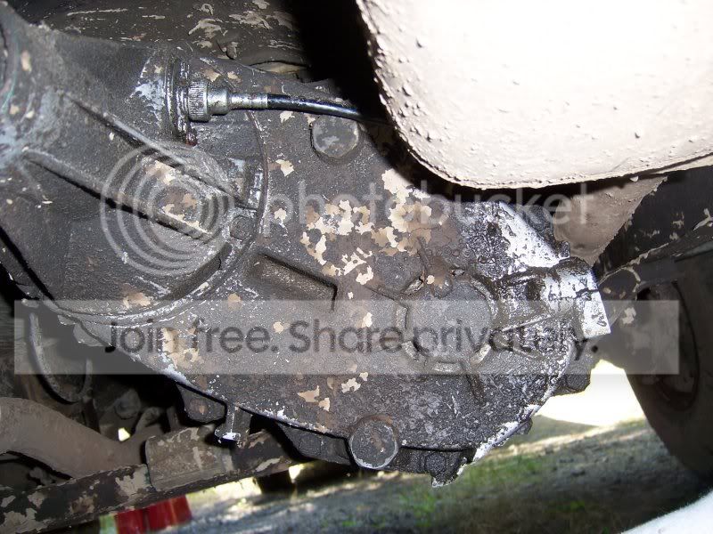

Now here's the two strange things.. I thought my case was was a NP208 that took ATF for fluid. Unfortunatly I didn't have my tools today so I couldn't open the fill plug and take a look :( I havn't put any in or checked it YET but I plan to.
Here's a picture of it, filthy at that:
I found kinda fresh gear oil on the outside near the drain plug(not much but it was definatly gear oil). I also noticed that it looks like there's red RTV where the two halves of the case bolt together(almost like someone had it apart at one time).
The other thing I noticed was on the top of the case, there was a plug with two wires on it and the wires were cut and taped. Whats the deal with that?
The NP208 and NP241 both take ATF. If there's gear oil in there then the PO made a mistake. The wires coming out the top are for your 4wheel drive indicator light.
Sounds to me like someone has been messin around with your tcase...
Not taking it out till I get a look in there. That does look like a 208 right? The gear oil could possibly be from the trans, but when I checked that it looked fine and full.
you can see the outline of the tag in the pic, its directly below the bolt holding the tailshaft housing on. clean that off. it will tell you the model, build date and ratio.
