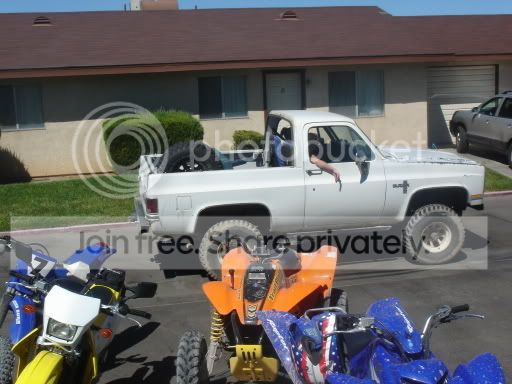

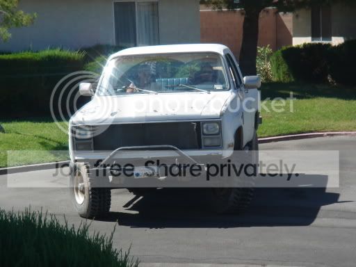

well i am loving the truck. but i am not too impressed with my first diesel.. i would like some more power.. no tire spin= no fun.
She looks fine to me. :D
Nice truck you have there as well. :haha:
