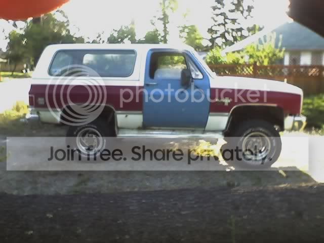

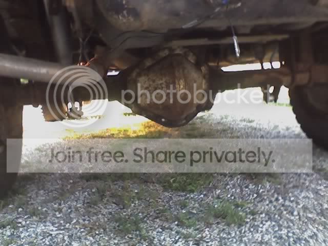

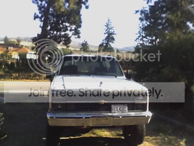

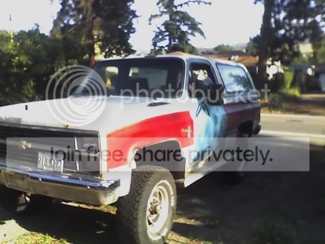

well guys heres a pic of my 84 K5 work in progress when i bought her she had smashed up doors so i got some rust free doors for her, then i swapped the old 10 bolts outta her for my full 3/4 ton suspension swap 4 inch lift and 3 inch body lift waiting to go on got 33" BFG all terrains on her right now sucks but my buddy is phoning up interco for my 42" IROKS and super lift for my 12" Lift kit lol next swap im putting in a SBC 400 into her, then a TH400/NP205 setup to finish it for a while she needs some body work but it gets me around lol shes a redneck mobile right now till i get the new hood on and the new interior i wont roller coat her just yet lol :laugh: so here is some pics lol

Yukon just released a 5.38:1 ratio ring and pinion set for the 14 bolt FF. That is as deep as you can go with your axles.
With 5.38's, 42" tires, 3rd gear and transfer case in high it'll take 3,013rpm to do 70 so with friction say 3,100. Not that I'm an expert but if you plan on keeping that beast street worthy and not having overheating issues you might want to go a touch higher. Maybe 5.13's it'll drop it down to 2,872.
Just something to think about if you plan on driving it to the trails and such.
-Avery
