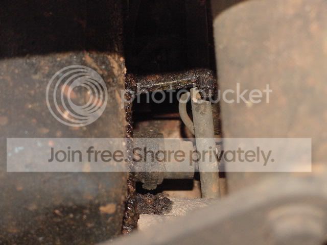

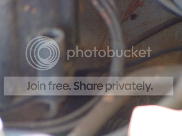

someone please help me identify these. am I correct in assuming that:
this is the water temp sensor (its on the head, not the manifold)
and this is the oil pressure sensor

Can't tell for sure from the pics but it "looks" like the right part in the 1st pic.
Yes watter will come out when U pull it, but not like it's under pressure or anything (so long as the engine is cool that is :crazy: )
I use teflon tape on mine and have no problems.
The temp light will not come on when un-hooked, but the oil light should, should be on all the time the key is on and the engine is not.
