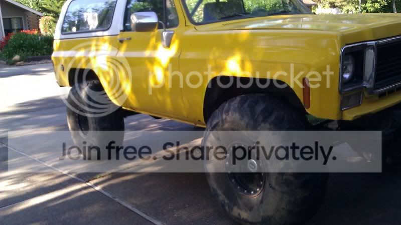

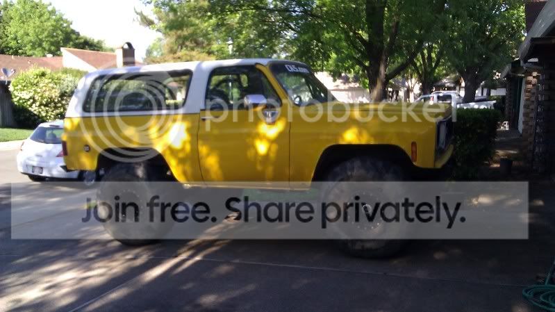

Here's mine, about 8" lift w/ 43's. When I cut the wheel openings not only did I open up the front and rear but I also went across the top. I never liked the factory "flare" around the opening so I cut it all out. I have not flexed it yet but I'm sure I'll have to trim the front of the fenders more.
Oh yeah, That's what I'm talking about right there. Pure Bdass with a touch of K5 sexyness,
