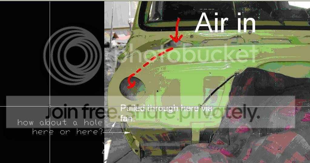

Greg,
I know on the A/C trucks the flaps automatically close and take air in from inside the truck when the vent lever is pulled to the "A/C" or "Inside".
Although the drivers needs to be pulled by the driver.
If you don't have A/C and don't mind not haveing the minimal ventiliation those vents provide I'd say weld them up.
The fan does suck air from the passenger side plenum though.
see the round hole in this pic.
So blocking off that portion from above would yield no air flow and then if your window fogs up your kinda screwed.
Could you relocate the intake hole to somewhere else?
Just a thought.

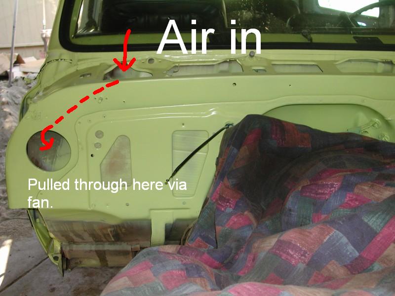

Greg,
