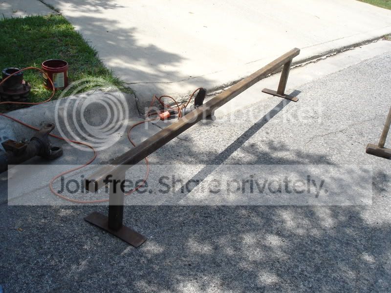

here was my breaker bar
ive got it torn down to the bare housing except for the inner seals.
