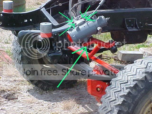

Remove the sector shaft nut(big arrow) and pitman arm.
remove the 4 bolts that hold the shaft in place(little arrows)....I would pull the aluminum cap with the shaft, but that is just me. Tap on the shaft with a soft faced malett and it should pull right out the top of the box...Have the steering straight....
