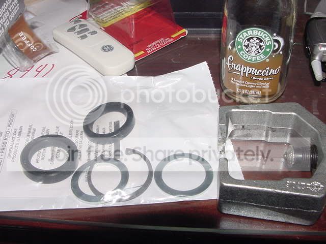

Dude, I got the seal kit from autozone for $10. It works perfectly, I just need to get some better snap ring pliars to reinstall my snap ring. You don't have to remove your sector shaft, you can actually turn the steering all the way to the left after you have removed the snap ring and first washer.. the pressure will blow the 2 seals and other washer right out. The instuctions tell you how. I linked to the part number in my thread about it, which is at the top of the garage right now. Here's what the kit looks like:
what kinda seal is it ?
looks like a wheel seal kind of seal in that pic
what seal kit did you ask for ? input one or entire box one?

Where are you leaking from, the rag joint area, or are you gushing fluid from your sector shaft straight down onto your pitman arm? This was the sector shaft seal kit. Not a complete kit. Its only 10 dollars.
That is the pitman shaft seal kit..
If you need the seal where the steering colum rag joint bolts on,the Chicago-Rawhide # is 7905 for 73-88 GM's..67-72 boxes use a #8660 seal there..both take a # B148 bearing also..
