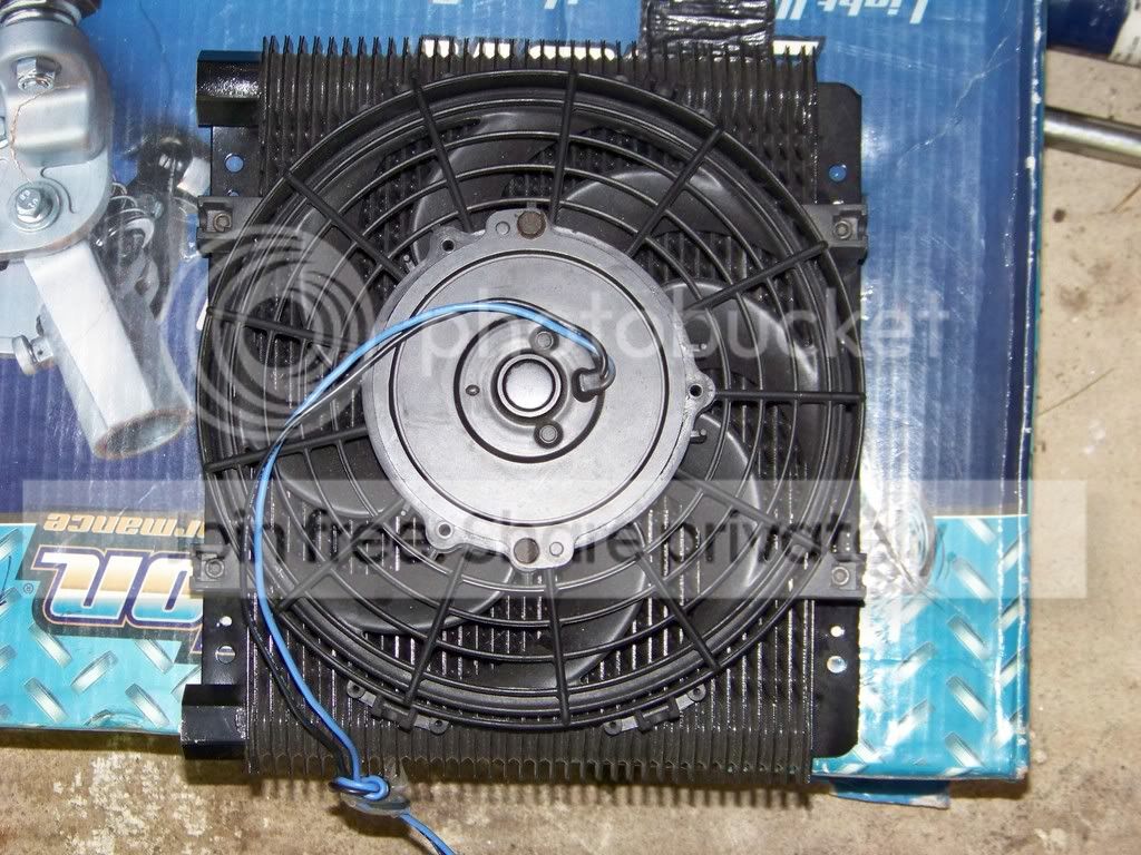

i have some overkill and havnt used it yet this is what im gonna use (since i no one bought it)

I have the same cooler as twoslo4fiveo but without the fan. Just having the extra volume makes a world of difference
