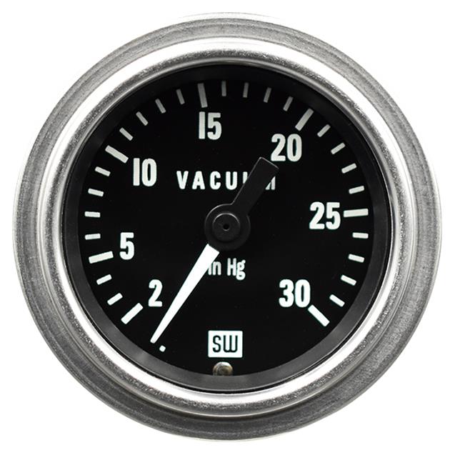

I think you are correct suspecting the timing. Need to prove the timing marks are correct and the balancer and timing pointer are matched. There are 2 different timing sets. 12 and 2 o'clock. If the outer ring on balancer has spun, then the timing marks useless. You could try timing by vacuum. Use a vacuum gauge reading manifold vacuum. retard the timing until rpm drops and the vacuum is low bouncing needle. Then advance timing till highest vacuum reading, you can stop there or retard till vacuum drops 1 inch. Then adjust idle air screws and idle rpm.

in Hg is a measurement of pressure that comes from a literal 1" change on a column of mercury, but now we have it printed on the gauge, so dropping 1 tick mark:
If for some reason you were connecting a mercurial barometer to the engine, then you would be looking for a literal inch of change with a ruler.

So with the vacuum advance plugged in, I turned the distributor and get a maximum of 20 on the vacuum guage. The PCV valve is making a lot or racket. Rapid rattling. When cold ot starts fine. When hot it still struggles to start most of the time. No pinging during acceleration that I can hear. How to I test the distributor to see of the advance is ha going up or something? Should I replace the whole distributor or maybe part it? I have a few spares that I think would fit.

Tried bypassing the vacuum advance - no change. Tried timing using vacuum gauge - no change. Tried moving the distributor all over the place - no help.
