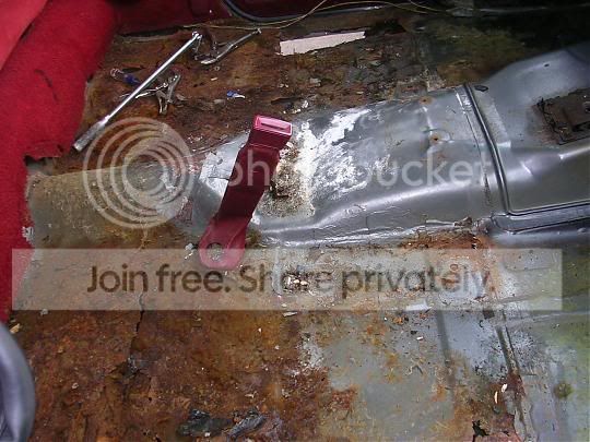

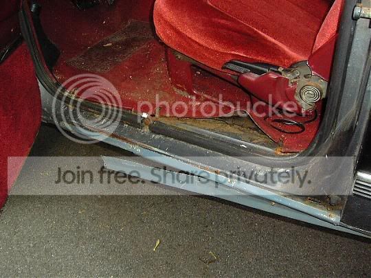

So now I just have stock bumpers that are black. Over the summer, we fought cancer

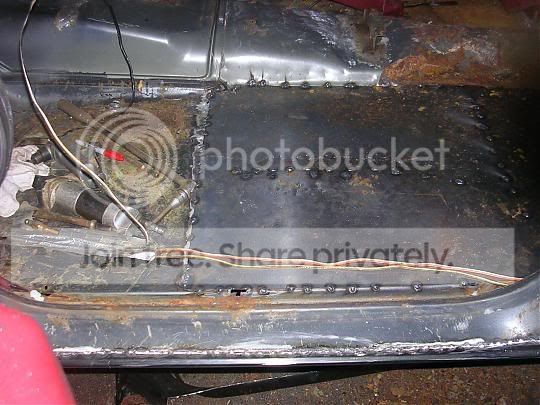

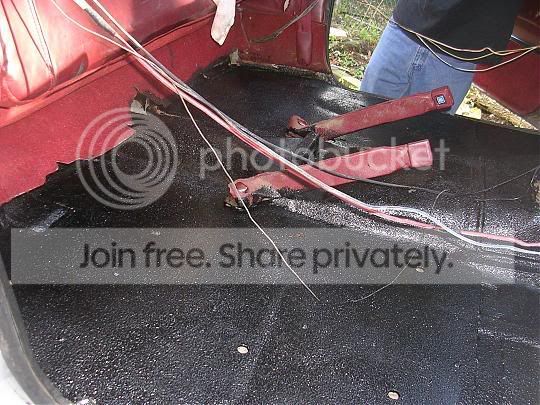

After that was done, with much procrastination, I went ahead and herced the floor.

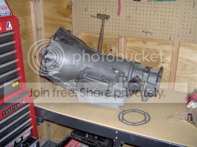

a super built 700r4 w/ extra clutches, hardened sprag, kevlar bands, and corvette servo,deep finned pan with drain plug,and a brand new "K" case (this tranny is practially brand new, I don`t think there`s anything else that could be replaced). Now, agree or disagree, I think this is going to be somewhat of a "bombproof" setup, which is what I`m going for. It`s all about peace of mind!
