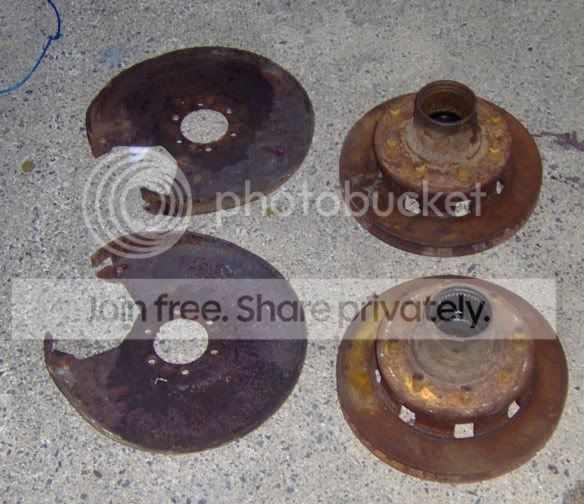

well, just got back from a little road trip...took a ride down to RI to pick up some things I`ll be needing for the 8 lug swap...pics to follow (tomorrow)
for those interested
(5) 16x10s (these will soon be scuffed up, and prepped to be painted, most likely black, unless someone wants to come up with a cool color scheme)
yea, I know, but its only temporary;) ;) This is just so I can get all set up for 8 lugs, as soon as its all done, i`ll start saving again to do it the right way, don`t you worry;)
don`t worry everyone, the rims will be stripped and painted black:D

Not sure what you mean by that...what seems like a waste? getting the 8 lug wheels, or the 8 lug conversion parts?
The reason I bought the 8 lug conv. parts was because I`m getting a deal that will contain a R&P set for my front 10b so I can gear it till match, which I will just run till it breaks..i only payed $50 for the outers and backing plates..will cost about 3-400 to regear...I`ll be running the 10b for a while, most likely until I can get about 1k saved up so I can grab a D60 in really good shape....money well spent IMO, cheaper than what most others have paid...
