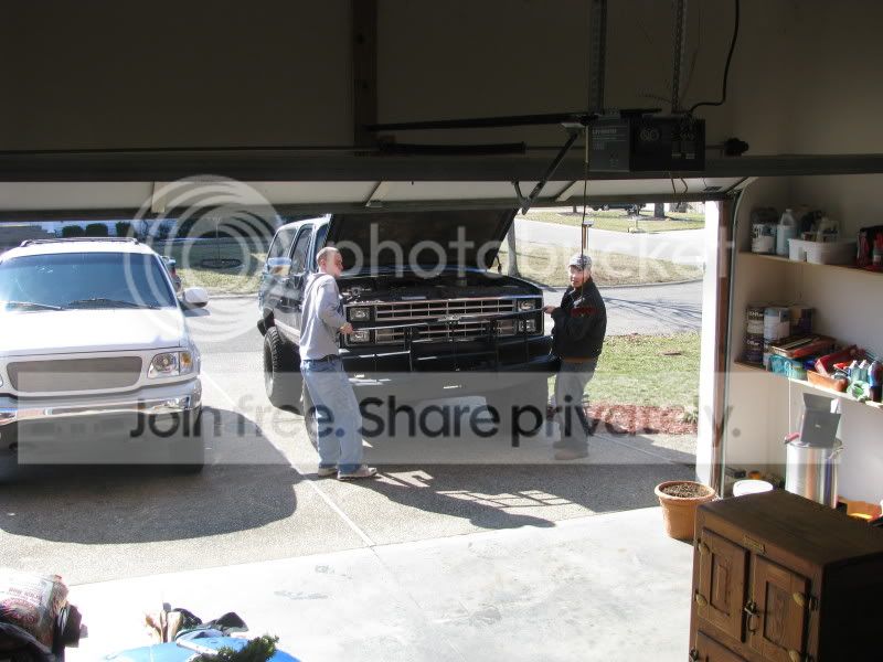

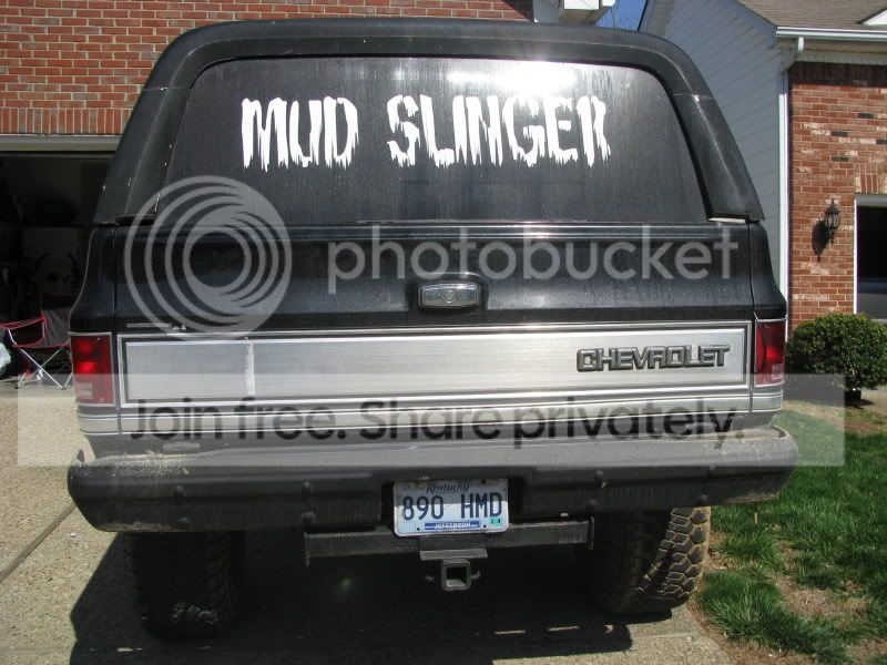

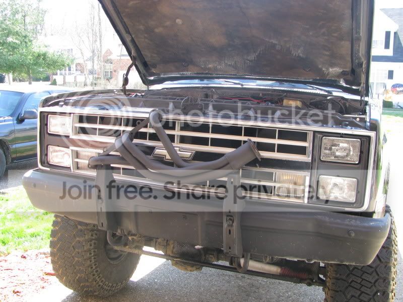

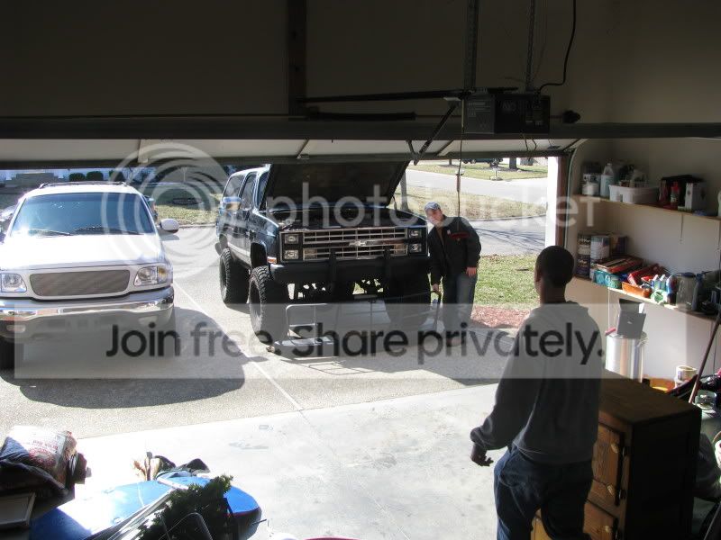

new pictures of upcoming installs. cant wait. im the dude ith the hat on, on the right that bumper is heavy as a fat chick on thanksgiving

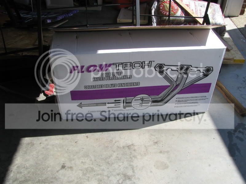

havnt installed them i gott get n o2 bung drilled in. part number is in the garage i think its like 11500fl or something
Nice Rig, really like how the bumpers came out. Will be waiting for more pics, keep it up!!!!!!!!
i still cant get the friggin front bumper off to put my new one on. i mean those bolts are either rusted on or im not turning the right ones anyone got any pics haynes manual sucks
There are 3 or 4 on each frame ear(3 on sides, 1 on top each side), and two more for the outrigger that go from the outer edge of the bumper to the frame.
I had trouble getting the rear bumper off my parts truck. The carriage bolts would just spin in the bracket so I couldn't get the nuts off. I gave up and scrapped it with the bumper still on. To get it off I would have had to probly cut off the heads or grind flats into them so I could grab them with a wrench,
i got it at pull a part i think its a modified arb bumper i will sell it for $600 bucks if i cant get it on
did you try anymore at getting the bumper bolts off? if you don't want to burn them off you can always get an air gun or a breaker bar and a piece of pipe

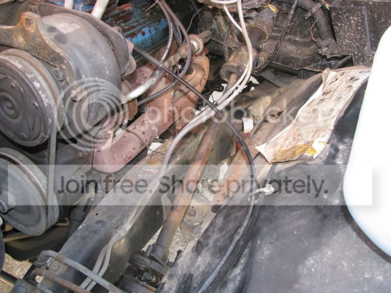

ALSO my headers i bought dont have an o2 bung is 20 bucks a good price to have one put in? just got a quote the other day? thanks guys
