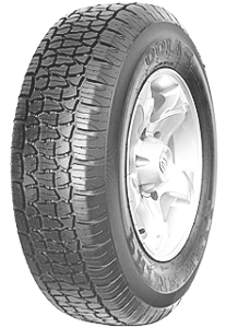

Im also shopping for tires, looks like the Primewell PA100 tire is $100 each in 31's, thats a smoking deal and I can use all *four* of the snow chains I have, since they are for that size tire. :bow:
If it snows like it did last year, Im in for a real treat!
