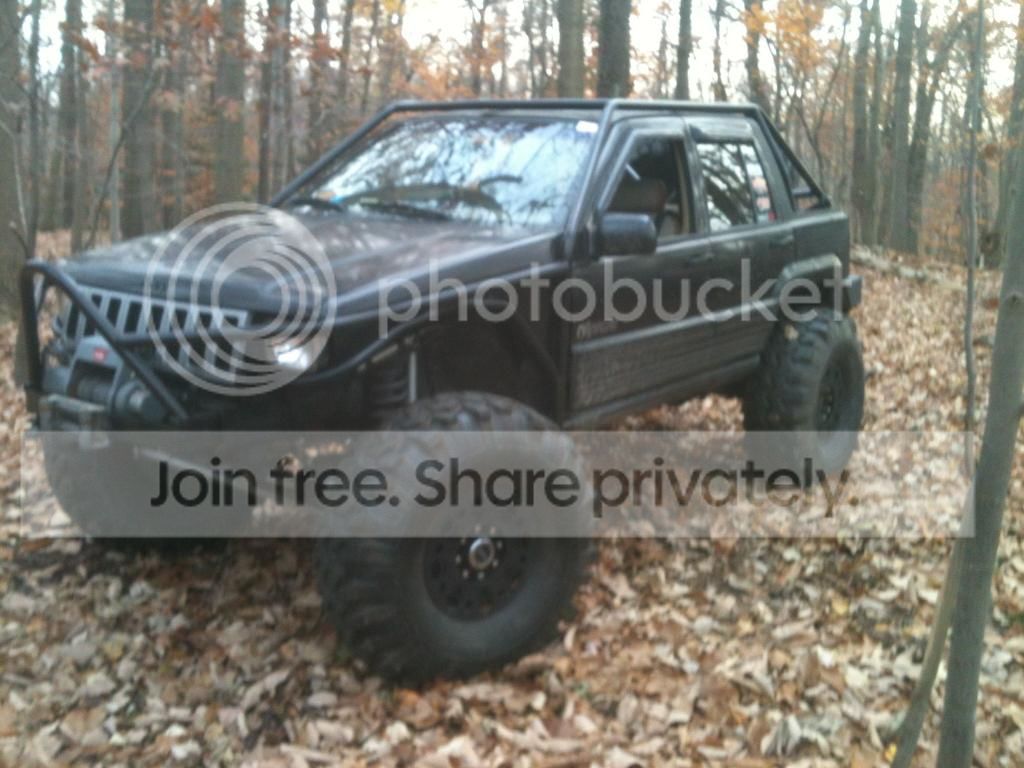

Some of you may have seen my Grand at Rausch before:

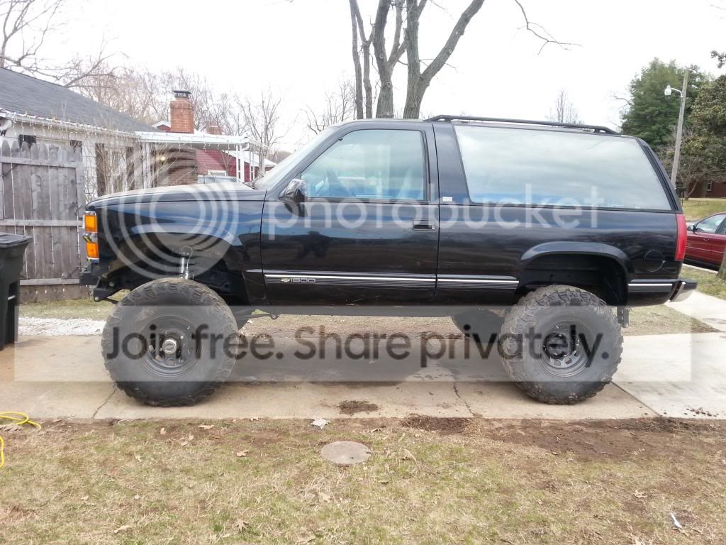

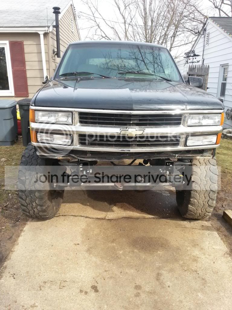

Here's where the magic happens:
And like I said I suck at pictures but here are the specs and a few pics of it as it sits currently and i'm going to try and update as I build bumpers and body protection, and get the suspension dialed in.
Specs:
TBI 350
4l60
NP241 JB SYE with 1350 Flange
Ford Dana 60 5.13 Gears, Lockright, Springless Highsteer arms, Ruffstuff dif cover
14 Bolt rear Shaved, 5.13 Gears, detroit, disc brake conversion, Ruffstuff Pinion gaurd and dif cover
ORD SAS Kit with new 52" springs
DIY4x Rear shackle flip with stock 54" springs and a zero rate
New 1350 rear CV shaft
New 1330 front CV shaft
New brake lines front to back
Hydro Assist with rebuilt and tapped box, PSC high flow pump, PSC cylinder and custom lines
Swapped in a disc/disc master cylinder from and 02 Tahoe and ssbc adjustable prop valve
Custom shock mounts front and rear
38x15.5x16 TSL SSRs with staun internal beadlocks

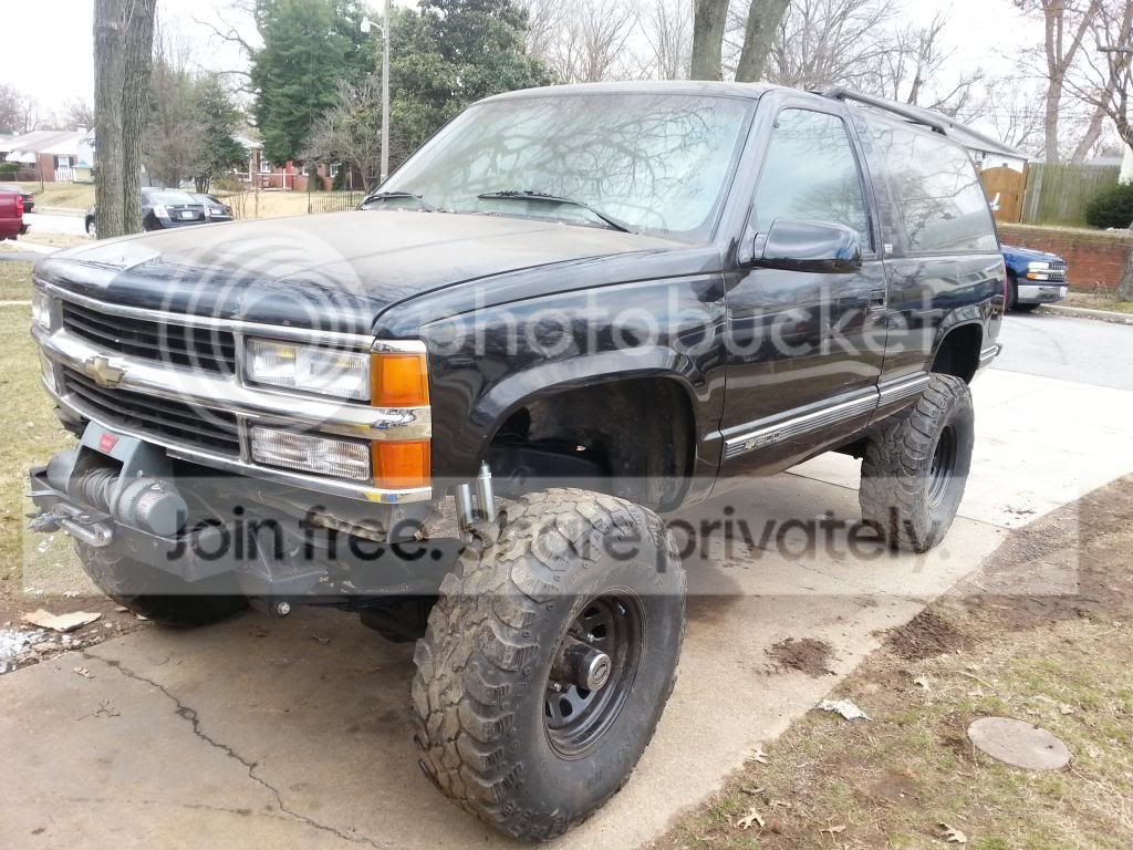

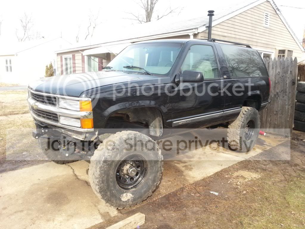

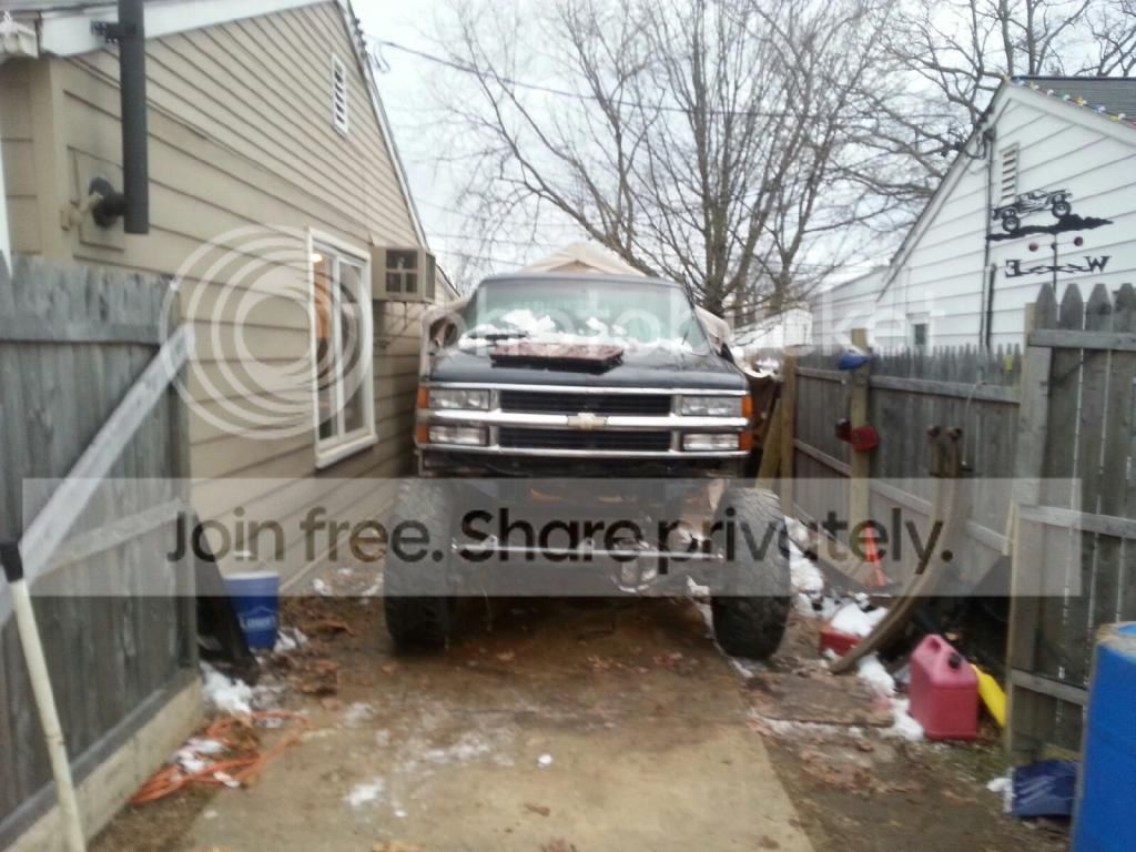

First time it rolled out of the car port:
First run under it own power:
Here's my son working on his ride while I swapped the new meats onto the blazer:

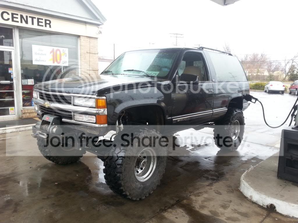

And one of the first trip to the gas station:
I'm going to snap a few detailed suspension pics tomorrow and try and get them up here
