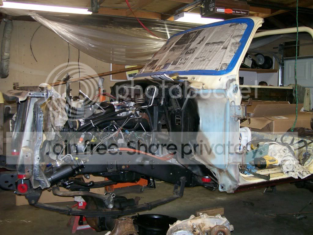

Project K-1 coming together!! I put the axles underneath and realized WOW this thing is gonna be be tall!! I'm gonna need a wheel barrel to haul my testicles around in!! LOL :haha:
Looks like 4" springs and 1" body lift? If so, you're short. You must be what, 5' tall?
Isn't that a HP Ford Dana 60? You can lower the truck a little by swapping to a 1/2-ton axle. I may be willing to trade...
You got a build thread??
I like it. I was gonna mention the 5" lift and you barely being able to see over the bed :doah:
I'm jealous. :p:
Gotta get working on my 14-bolt. Gotta find a D60 for less than $1000 around here. :crazy:
I'm waiting to start a build thread until I get mostly done, I don't know how long it's gonna take.
it's gonna go up another 5" with the tires
spec sheet on this so far,
98 H-1 drive train w/ all wiring and pcm
that's a 6.5l center mount turbo diesel
4l80E and 242 full time t-case
front ford 60
rear 14 bolt 4.56 gears and detroit
ORD engine crossmember, brake line kit, U-bolt flip, crossover kit, HD tie rod, greasable shackle bushings, and 1" body lift
Chickenrammit fab t-case crossmember
PSC steering kit with hydro assist
tuff country 4" lift springs, rear 56" from a suburban
A/C, and hydoboost from 3/4 ton diesel burban
painless harness
