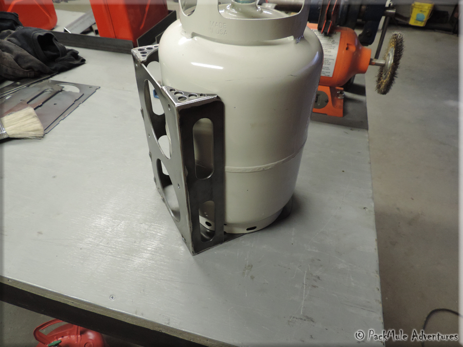

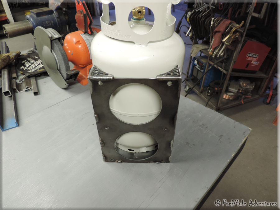

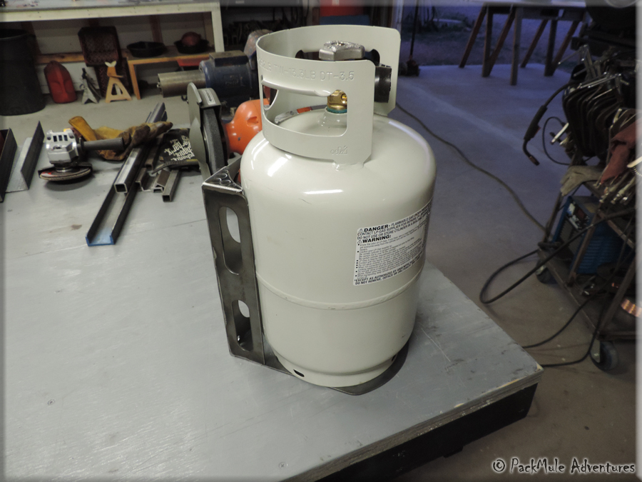

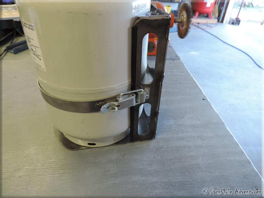

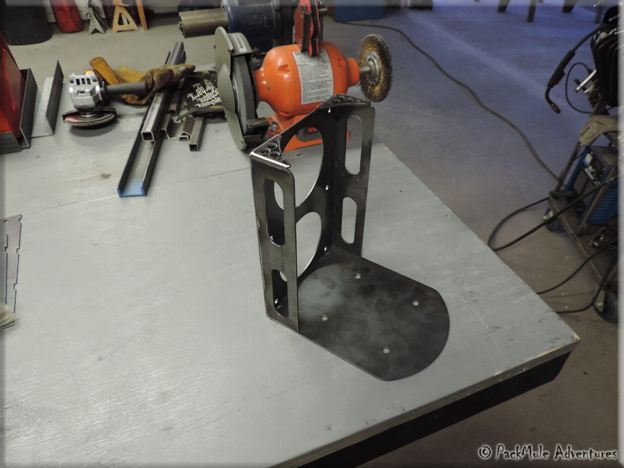

Working on the passenger side swing out arm now. This one will hold two Jerry Cans, a 20lb C02 bottle and a 12lb Propane tank.
Only one place was selling a mount for the some what popular 12lb bottle. so I made one myself. Its still ugly but its the first prototype. This one will work but already I am going to have another ran off with some tweaks.
Ignore the small holy gussets on top. It needed something up there and those were laying around.
I prefer it when the bottom is actually open and uses a small vertical tab to hole the lower ring onto it, so when the bottle is removed it doesn't hang way out there. But it does look sexy. A ratchet strap and some kind of lock and it's perfect.
I'm gonna hot link it, hopefully it works....................
Something like this........
Notice how the base holds it without sticking way out?
Ok I see what you are talking about. I thought about something like that but i wanted some extra protection underneath of the tank when its mounted. Pretty much the tank will always be mounted so i don,t have to worry about a empty bracket getting bent I just have to worry about the tank getting damaged.:whistle:
The idea is this will be a mount you can mount where ever you like.

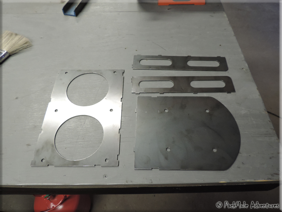

Precut Mounting Kits...
For those of us who do not have a plasma cutter, where do we find a precut propane bottle mounting kit like the one you made earlier? I'd actually like a precut kit for mounting two NATO gas cans side by side. Anyone have a website address where I can look at available kits?
